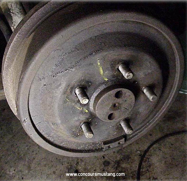

Also does anyone have a picture of an original rear drum? Mine were replaced with units made in China and I'm not exactly sure what the originals looked like.
Ignore the yellow marks
Your car would likely not have the drums blacked out

Thanks again! I will try to source some drums that look like these.
