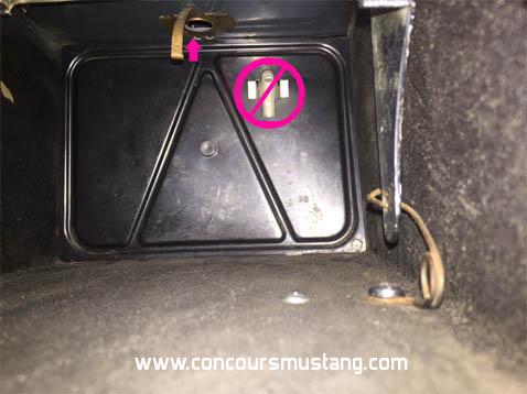

As a side question did the console get added to your car at some time int he past. Would expect that a car built (very late 66) when yours was to have the top light that goes on automatically when the door is open rather than the one at the back side of the compartment like you show. (added to the original post) in the lamp holder shown in your third picture
On a 65 console (not convinced that the change over was at the model year - other changes were not) the interior compartment light works off of the interior lights if I recall correctly = been a while. Is the rear (on the console) lamp working?

   Josep if you notice in the third picture (should have blown that one up earlier) you posted your console is from a 66 and correct for a late 66 San Jose car but it would have come equipped with a lamp holder in that top holder and not the little one you are trying to add to the rear. Bought and sold over 150 of these early in my Mustang hobby life.  Lamp holder (metal part) is very similar to the metal holders for the underdash courtesy lights
When the door is open it makes contact with the ground (through the door, down through the hinge springs, mounting screws and the metal front bracket/mount completely the circuit
« Last Edit: May 31, 2016, 09:06:05 PM by J_Speegle »
So Jeff, you mean that little lamp hasn't to be there.? So the back of the compartment must be wrong. Hole for the little lamp looks to be made mechanically. And where can I find this missing lamp holder.?

Lamp holder (metal part) is very similar to the metal holders for the underdash courtesy lights. When the door is open it makes contact with the ground (through the door, down through the hinge springs, mounting screws and the metal front bracket/mount completely the circuit
Think this is what you mean Jeff.
