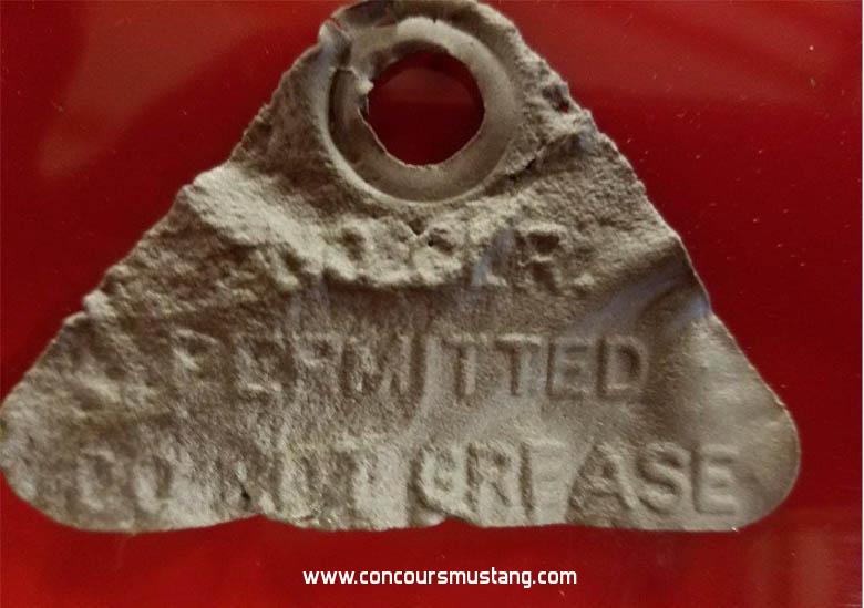

Hi Guys,
I found these tags on my wife's Sept 64 SJ convertible. Ball joints are bolted in so the were replaced right?
Are the tags original?
Dan.

Re: 65 Upper Control Arm Tags
« Reply #1 on: March 18, 2016, 06:33:41 AM »
That is correct.  A pretty common wear item.
+1 . tags not assemblyline.

Labels were commonly included in the replacement kits of a number of the big suppliers in the 70-80's

« Reply #13 on: July 13, 2016, 01:08:33 AM »
Here is another example of ones used by some/one of the aftermarket ball joint makers in the past - sent to me by   drschones
