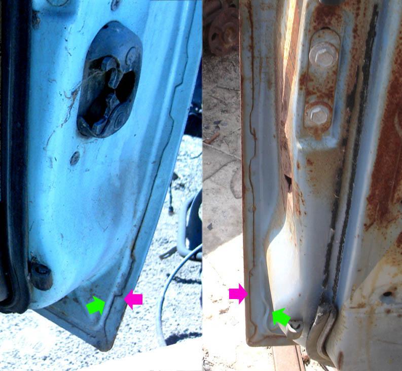

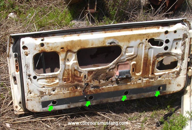

If you modifying one to the other you'll also need to concern yourself (besides the different shape shown in the other thread for the 70 Mach I molding and the three large holes)  with the edge of the outer lip as shown below. Either adding or removing based on what ever they did with the reproductions.
69 Passenger example on left - 70 Drivers on right
Shot of the 70 Mach I holes mentioned above

Thanks so what I'm seeing in this small area of the edge is a 70 style inner door and an outer edge shaped like neither (would need modification) 69 or 70
