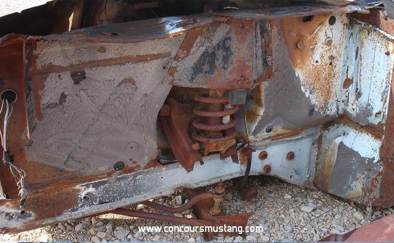

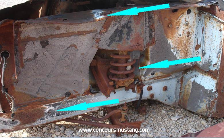

As a base, for the front frame primer sealer, I've found versions of batch paint used on this area at this plant and during this production year. Here are two examples shown below. One a very dark gray - the other a lighter blue gray (along the edge where they didn't cover it with undercoating)  Have others, from throughout the year, but this shows the wide range in color, tone and tint that was applied. Basically from a very dark gray - almost black to a blue or green tint gray
#1 - This is a southwestern car where the sun has baked off much of the black paint by storing it out side for many years. This one just shows how far the body color could be applied
Arrows indicate forward most evidence of the light blue body color in the picture
These arrows show some of the black paint application and how far rearward it reached. Since it has burn off it was likely another foot rearward with the lighter poorly covering overspray

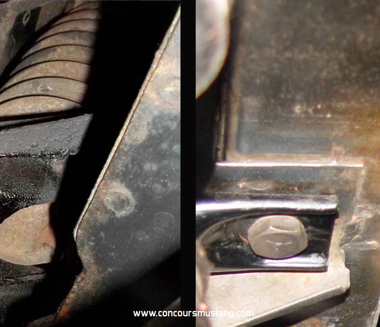

#2 - Another example. This time the red arrows indicate where the body color was applied forward and the black where the black paint (well at least on the frame rail as a gauge) appear to  have been

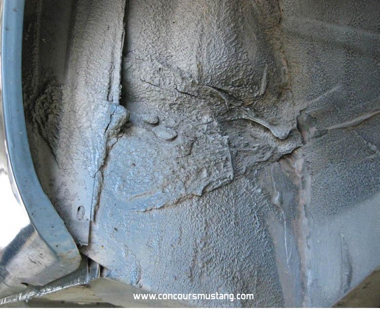

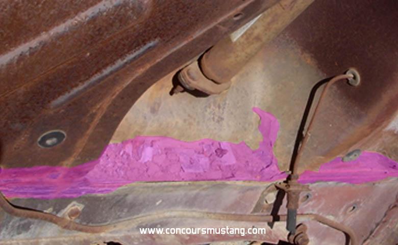

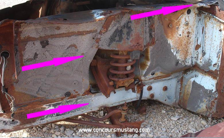

You asked about the panel edge sealants. Since Dearborn often applied a fairly heavy coat of sound deadener at that plant compared to others its often hard to determine the area of coverage and the amount. In the following pictures I tried to show what I can see as far as pattern, if the applied sealant (out of an application) was spread, how much and where on these examples to give you an idea
#3 - Almost erased by the amount of sound deadener applied some of applied sealant can still be made out

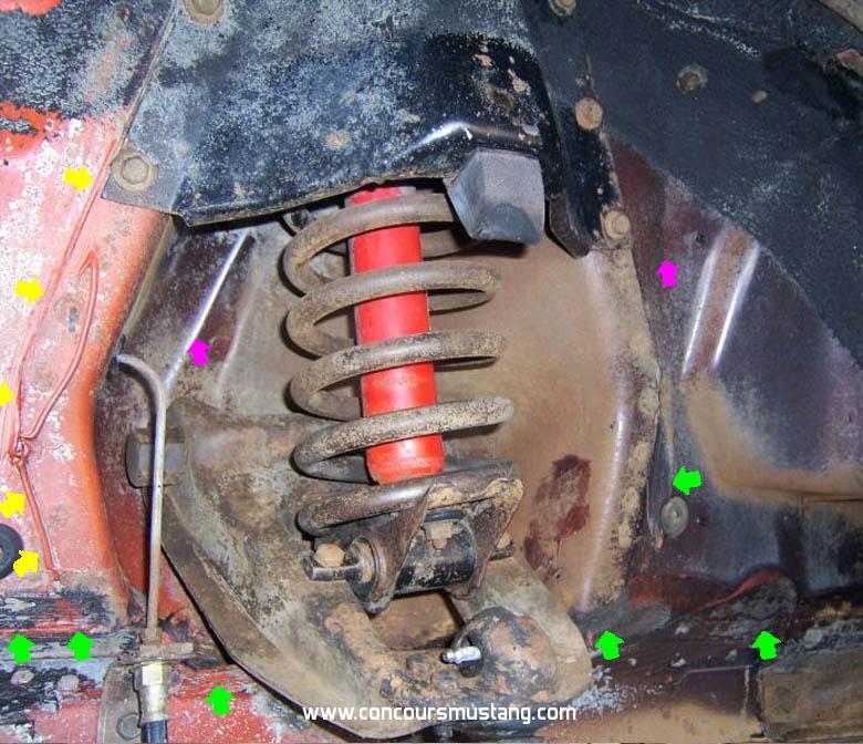

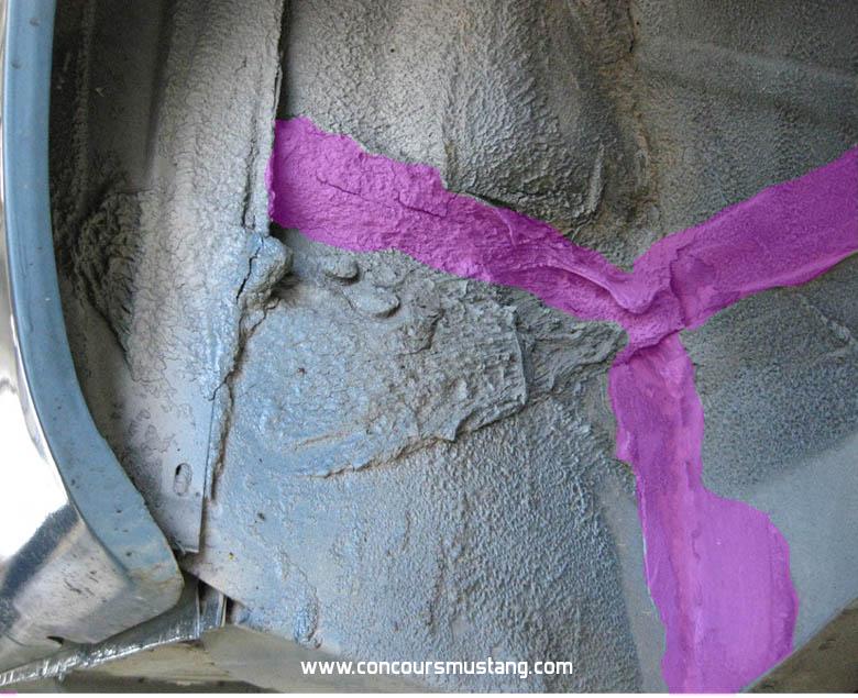

#4 - A much cleaner and nicer example from your cars period. You can make out the shock tower to inner fender panel sealant (yellow arrows) not spread with the soaked rag at the rear edge but spread at the forward seam (top forward most green arrow) but not as much applied there. Along the inner fender panel to frame edge you can make out the spread sealant under the paint coats that followed. Green arrows also
Appears to me that you can see through the thin black paint coat another color below (purple arrows). Likely the batch color that was used from the firewall forward or the body color below the thin black coat. Something is producing an almost deep purple or maroon color

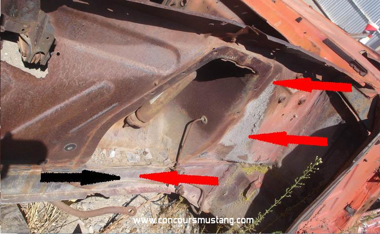

#5 - You also asked about the sealant into the shock tower pocket for this plant and period of time. Here is a well used car, but it does still provide evidence that this appears to have been a continuation of the frame to inner fender panel application. Highlighted to help you identify the pattern and area of coverage
