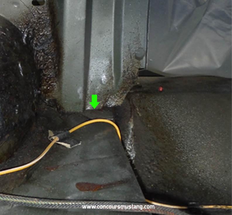

This is looking from in the trunk forward, the rear seat hatch to trunk would be on the right. Should that gap in the panel and the trunk floor be filled with something? I'm looking in the parts catalogs and not seeing anything.
« Last Edit: February 16, 2017, 04:42:50 PM by J_Speegle »
  • Posts: 24861
Re: 69 Fastback/Sportroof Trunk Panel Question
« Reply #1 on: February 16, 2017, 02:37:36 AM »
Looks like the trunk floor was possibly replaced and at least one bracket was not welded back to the car (would check the passenger side also)
Passenger side bracket for same purpose gap between panels can vary allot but they are designed that way to support where the more important visible outer panels align as they should
This gap and seam is often covered with a heavy spray sealant making seeing the panels and brackets difficult on an assembled car if its a fold down car but not impossible

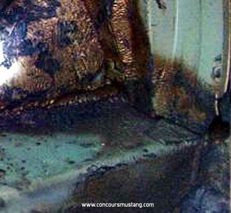

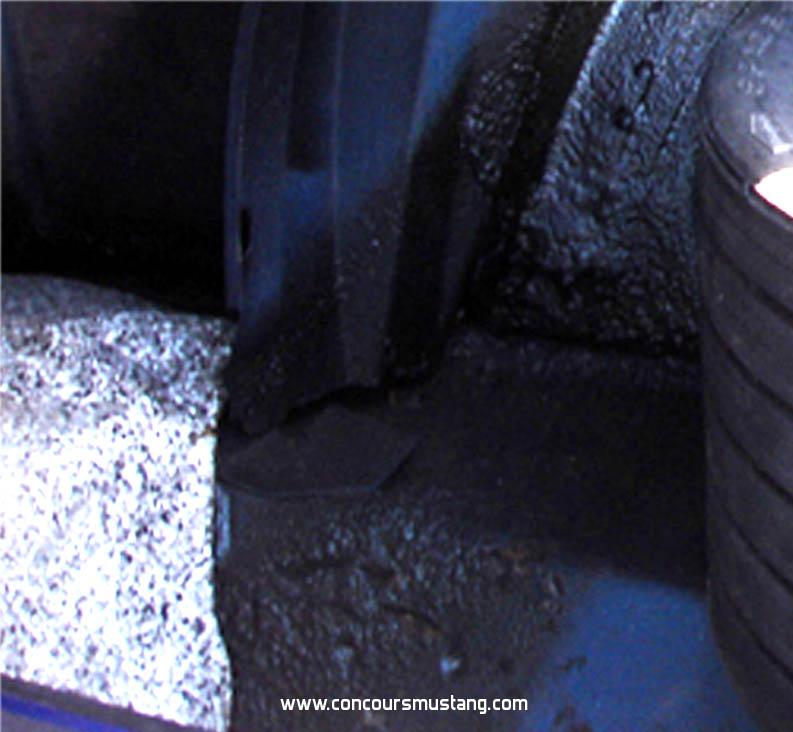

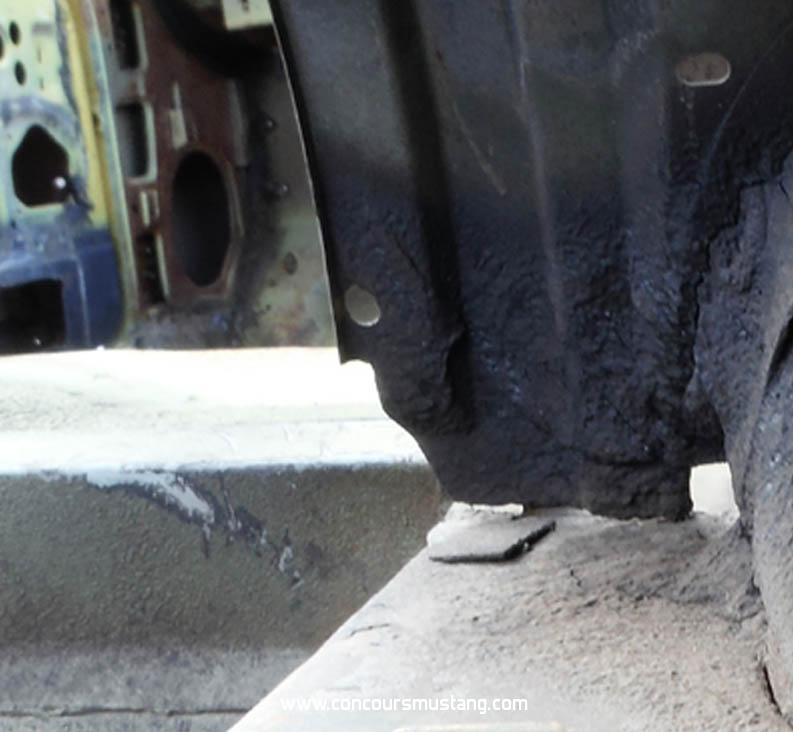

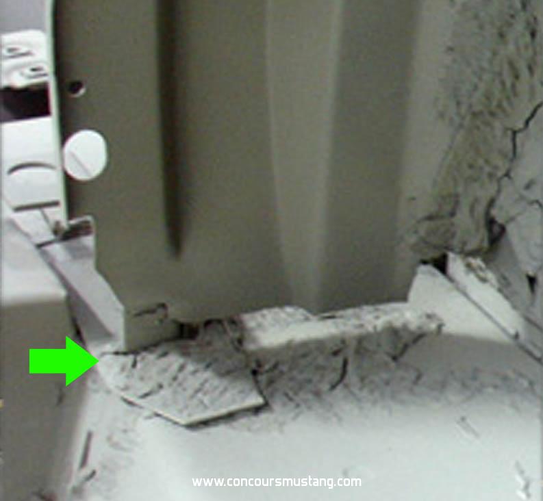

Looked quickly through my pictures and choose a couple of cars. Pictures are rarely perfect since they are not often taken of the detail you are now looking for
All the pictures below are from non-fold down cars This one from just before your car was built and from Dearborn (9F1810xx)
These two examples were built a week to two weeks after your car same plant both non Fold down cars   ( 9F1864xx & 9F1967xx)
