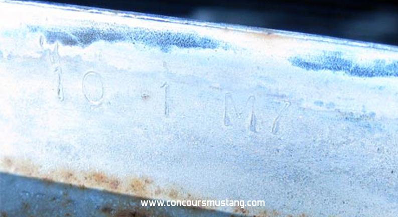

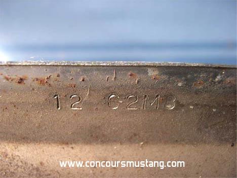

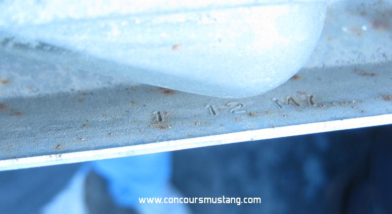

Well have not seen any bumpers stamped like the rear example. In addition to the one posted earlier by rodster Here are three more
As for your example could the "M3" be a porrly stamped or read "M8"? If so then the patter is reversed. Not normal but we do see through the years examples where the date ingots get put int he holders backwards or individual numbers/letters backwards. If so date isn't going to work with the car you mentioned
As for the front example - haven't seen an original with the additional digits on the end of the pattern But have seen allot less front bumpers for the 67-8s than rears for examples so could not eliminate it as a possibility of being an original or an early service replacement
