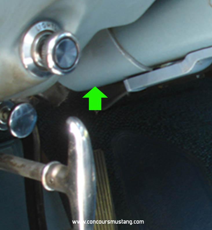

Bottom of the dash showing the non-tilt style column clamp/bracket

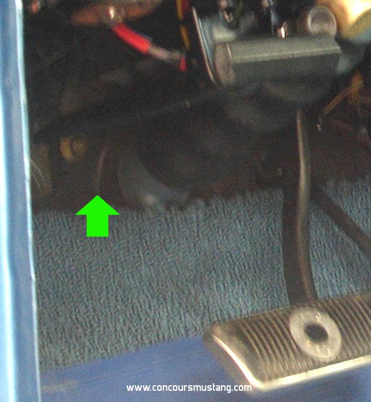

Bottom of firewall - showing black plate and one of the four big screw heads

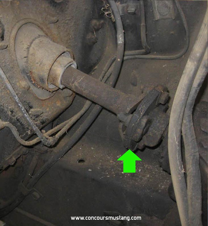

End of the column center steering shaft and rag joint attachment. Often this fibrous item fails or rots away

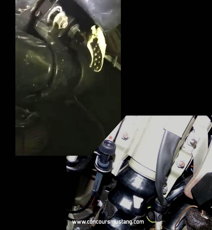

As far as under the dash it appears that you have a collection of non factory parts
Your car (in this area) appears to be a collection of parts put together without much focus on originality Your car is in the upper left and it shows that the clamp has aluminum blocks like that used in 69 and the bracket appears to have been made for those style of attachments. In contrast the lower right picture below shows a factory 68 mount. The clamps/bracket and attachment hardware are different between the two
Think this is where some of the other play is coming from in your demonstration
Looks like now (if you haven't already) is a good time to pick up a copy of the assembly manual that covers this area or a shop manual so that you can get all the correct parts, look at exploded views to see how all of this goes together and you can figure out what is not tight where it should be. We can only provide possibilities you have to do the work ;)
