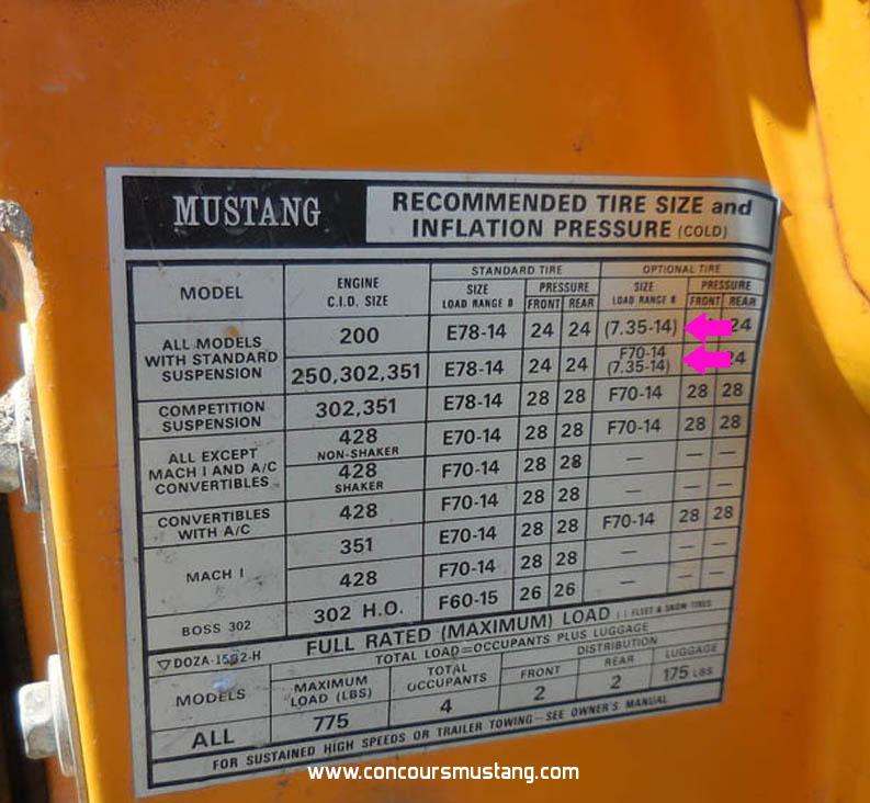

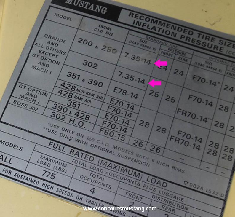

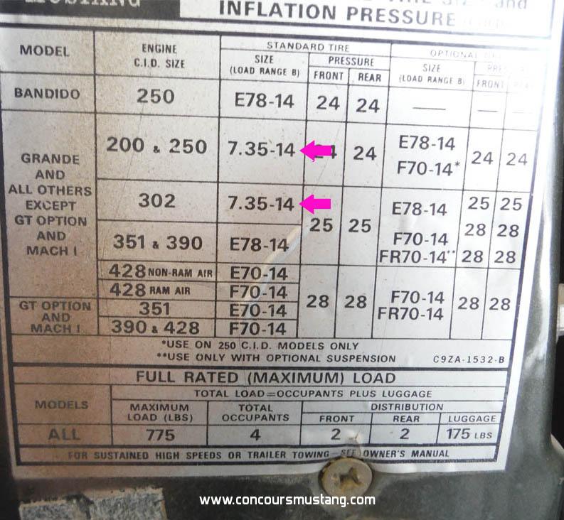

7.35 x 14 was a standard size used on 69 Mustangs as shown in the following original tire pressure decals from 69 Mustangs. In 70 they are listed next to E78 x 14's no D's and the 7.35 x 14 because optional on certain applications
On the 69 examples the standard tire is shown to the left and in a column to the right the option tire and size is shown
Three different versions used in 1969 production
And a 1970 year version
The link you supplied is a book likely assembled from the old (non Ford source) exchange manuals every wrecking yard had at one time showing what would fit or could be used to repair or replace. Think that is why we sometimes find American Motors stamped starters on soem Mustangs and other Fords today ;)
« Last Edit: April 05, 2017, 05:05:13 AM by J_Speegle »
