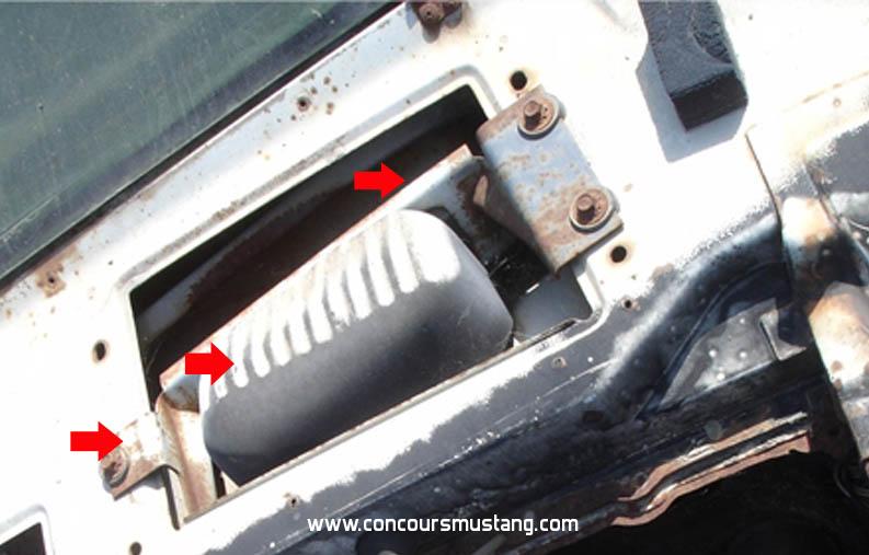

2- What color is the wiper motor and plastic cover supposed to be?
Wiper motor has a natural bare cast top or transmission section with a semi-gloss motor section. The steel bracket that attaches it to the car was paitned semi-gloss black before the rubber insulators were added. The plastic cover was unpainted black plastic

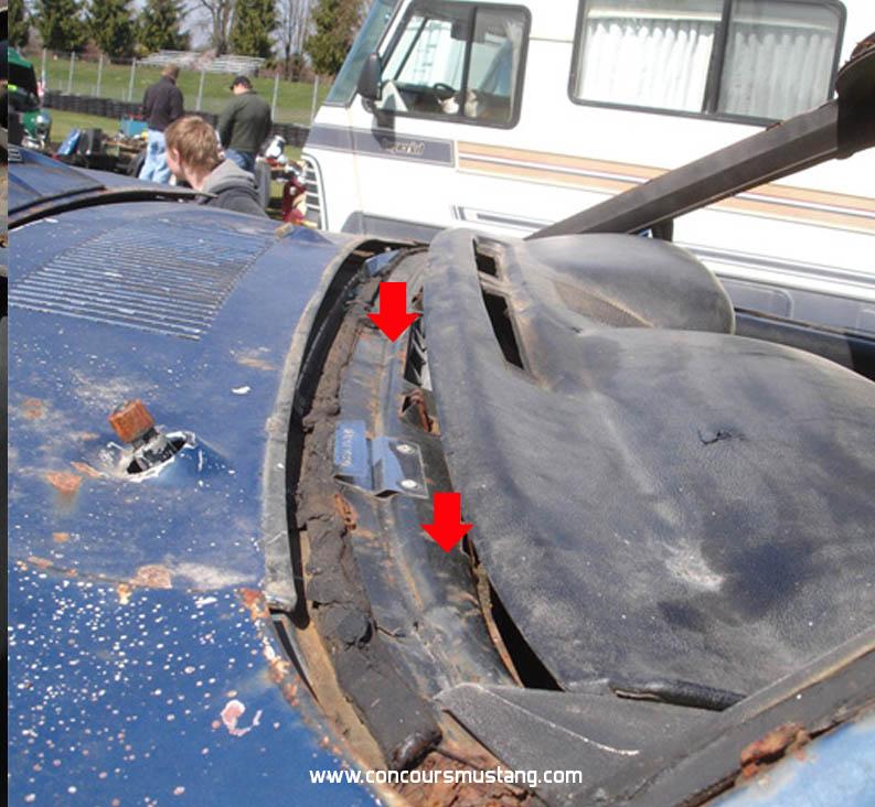

Was not unusual to have a small thin amount of black out applied to just the upper lip of the cowl panel to black out the area behind the VIN and gap around the dash pad
Once the hood and cowl cover were installed the hood black out for the Mach I and Boss package was done. This produced direct paint application to those items directly below the cowl cover grill openings and an overspray mist on the surrounding surfaces.  It could produce a "tiger stripe" pattern on those surfaces such as the top of the cowl, wiper motor cover (the plastic shield) and wiper motor bracket.

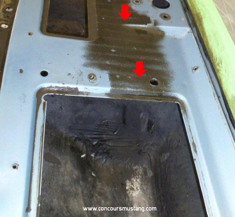

Though not in black  a similar pattern is produced (in this case in white) when a car was repainted later in life and the car was painted with the body panels in place. Ignore the black above the  engine compartment pinch weld - this is from a later example ;)

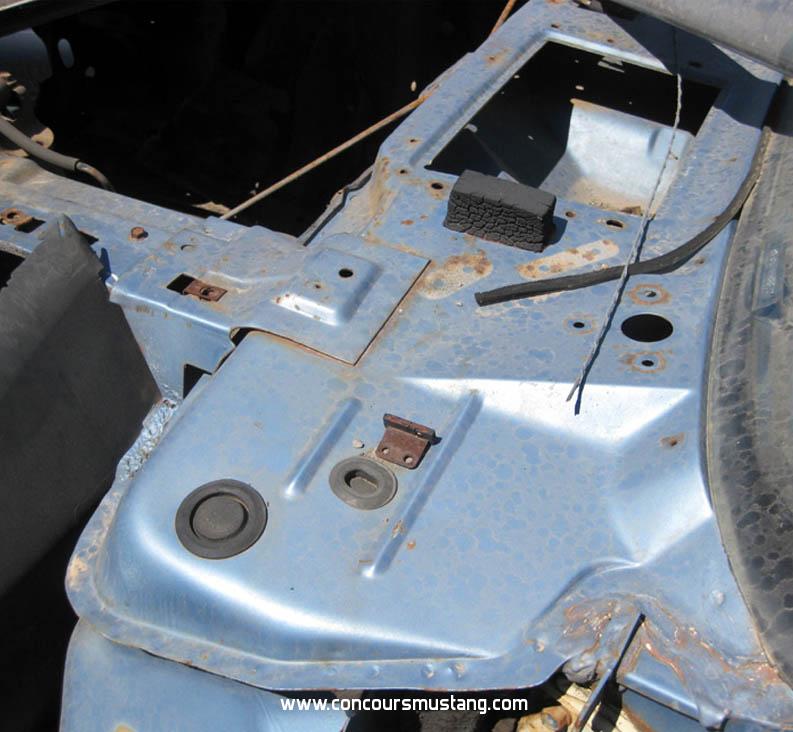

Did find an original paint San Jose example of the area. None of the Acapulco blue is visible but it does not show all angles
