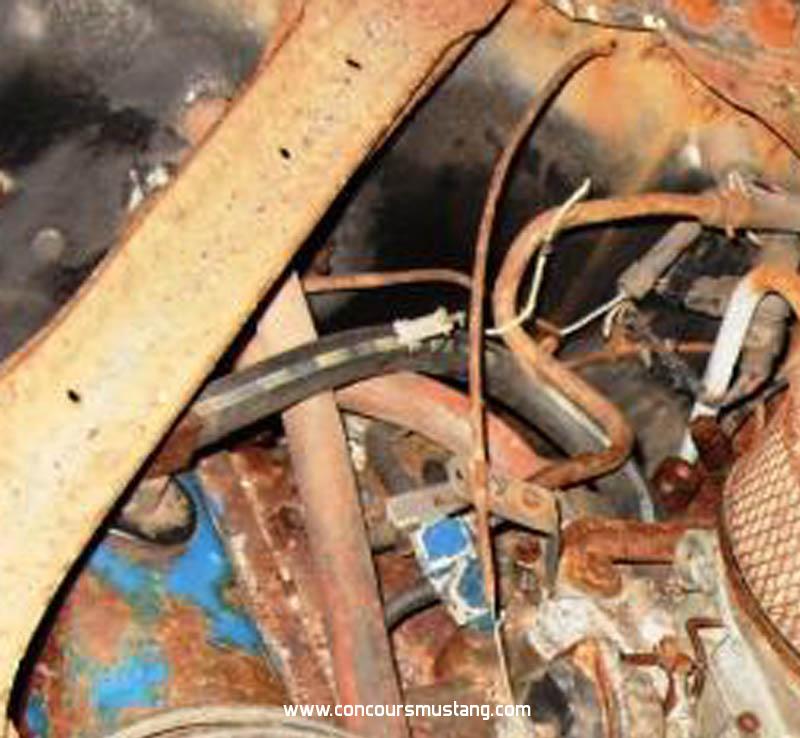

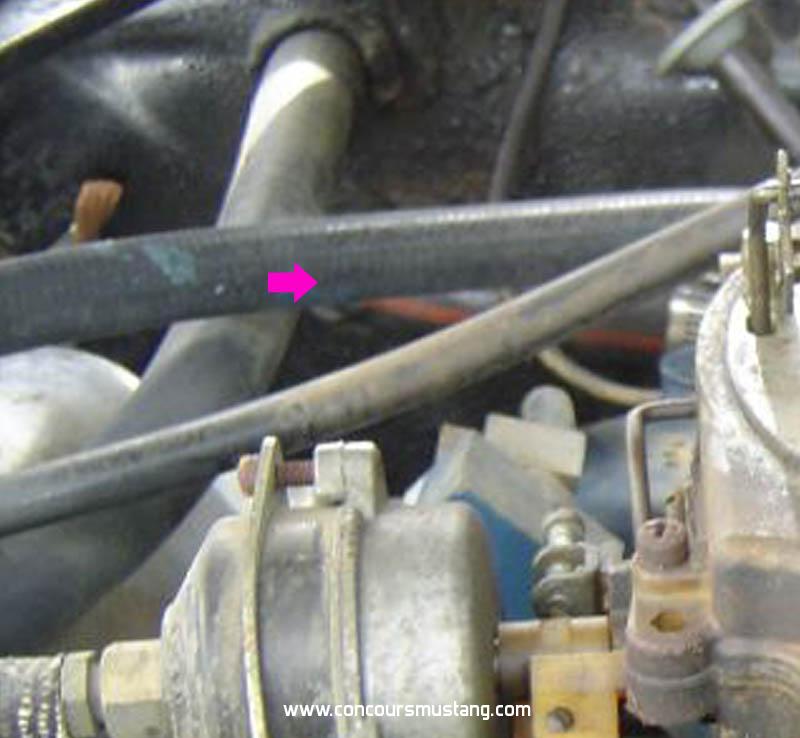

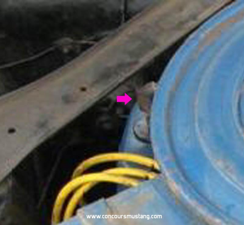

« Reply #4 on: May 07, 2017, 03:28:43 PM »
I did also find the manfield pictures but they are for the 390 gt. I could not find pictures of a 390. Maybe it is the same as the 390.
Are you asking about a car other than a Mustang or Cougar?  Only S codes were installed so not sure what the issue is with the pictures (including the Mansfield ones)  is
Will check and compare the pictures and when each of those were built. As for your link I think its kind of odd that the picture shown as a reproduction carries the incorrect markings for the application and instead maybe a generic (cut to fit) service part. Notice that its marked Motorcraft ;)
Just trying to help

« Reply #5 on: May 08, 2017, 01:59:16 PM »
Jeff
I just i realize your picture's are from an S-code, i looked at the mansfield picture because it was more detailed. When i look at your pictures more closely it seems to be the same as the mansfield picture. So no difference between a S-code and a S-code GT.
By the way I have a 69 mustang mach one with a S-code.
69 mach 1 390 toploader
built at San Jose Oct-25-1968
Re: correct pcv parts 390 4v
« Reply #6 on: May 08, 2017, 02:17:25 PM »
Yes they are both the same engine.  Have a couple of friends that have S code Mach I's that are restored. Back when they were done we had some challenges to start out with since so little attention is paid to that engine compared to the CJ's  as you have surely discovered ;)
