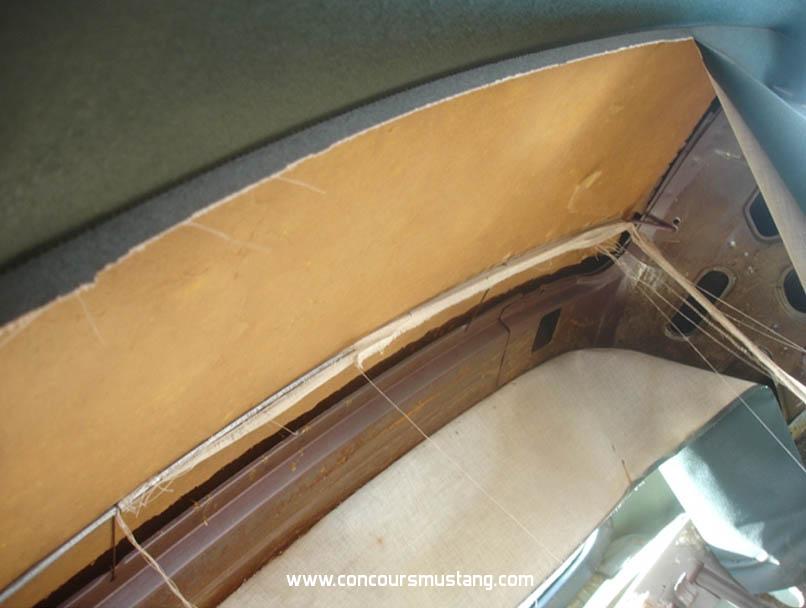

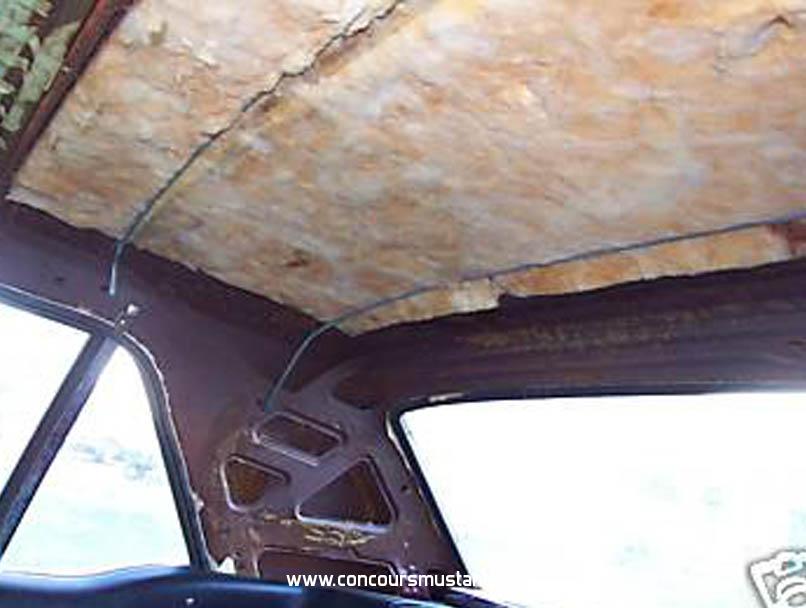

I brought home original material from a trip to AZ (personal junkyard) !    http://i38.photobucket.com/albums/e136/svo2scj/100_3884.jpg
Interesting. You know the question - ;)  what plant and what year was it found in?
Material or more likely supplier was a number of places and you can see some of the differences in the way the surface was made
A few more
5F07D158xxx
7R01C188xxx
9R01F140xxx
