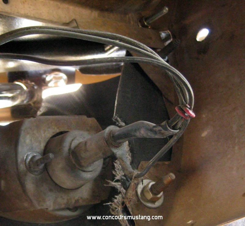

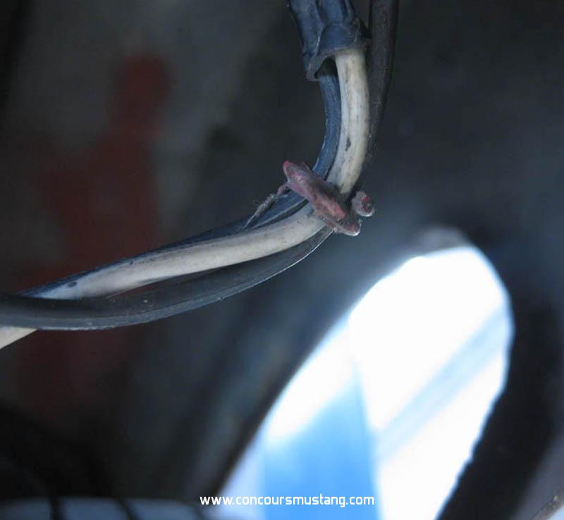

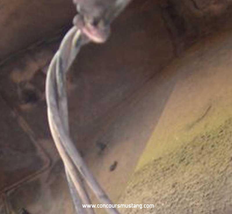

This subject came up in another thread when it was noted that the heavy wire clip/staple had been applied around the base of the wire loom near the lamp end of the loom
Appears to be that the clip/staple was dyed red originally. Looks like it may appear pink after years of exposure.
Have seen this on other years but we'll start with 67 since that is where the discussion started.
Will add my examples/evidence as I get time to post more
First set of examples are from 67 San Jose examples excluding (at this time) Shelby's just because I haven't gone through the thousand or more examples I have pictures of
7R01A1533xx
7R02C1583xx
7R01C1834xx

I have recreated this detail by taking a small wire and dipping it in red plasti-dip. Then wrap the wires and trim as needed.

So you believe or have confirmed its a coating rather than a dye on the metal?
Also have you found this a common detail on 68's at least NJ ones?

The ones I have seen are coated. It is a feature found on 1968 NJ cars
We should also say when buying NOS lights, be careful, because there are several versions of the wiring.

Looks like a seat cover hog ring

The most important detail for this "item" seems to be overlooked - we have "small" to "hog ring" as reference. What is the diameter? Does anybody have calipers? You can't paint/dye/color an intangible.
