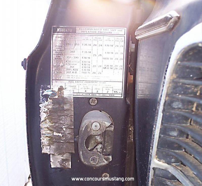

1. Tire Pressure decal goes on drivers side door just below the Latch?

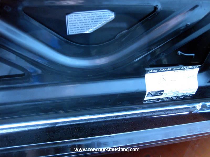

2. Jack decal goes on inside trunk lid above spare tire?  Should be appropriate for full size spare?

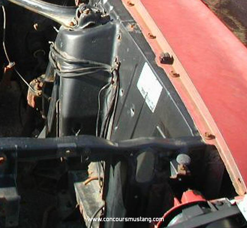

3. Service spec decal goes on left hand side shock tower?
No above the latch driver side door For the tire pressure decal your looking for the D0AZ- D it appears
Of course since the car likely didn't come with a space saver and I think you indicated that it was not a Mach I
Not normally on a car built when you indicate though there are a couple of examples from very late May with it there. More likely the inner fender panel drivers side

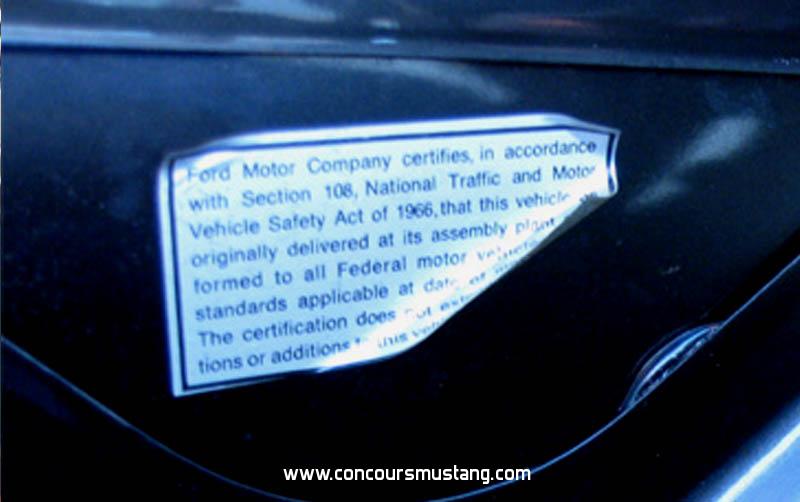

Are there other decals that I should purchase?[/quote]
- Battery inspection decal as Brian posted but don't buy the filled out one since its filled out as a 69 Dearborn car would have been done
- For the trunk you'll need the 1966 dated Federal highway decal also Shown above in trunk lid picture

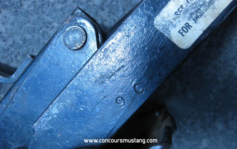

- Jack decal with rounded corners
