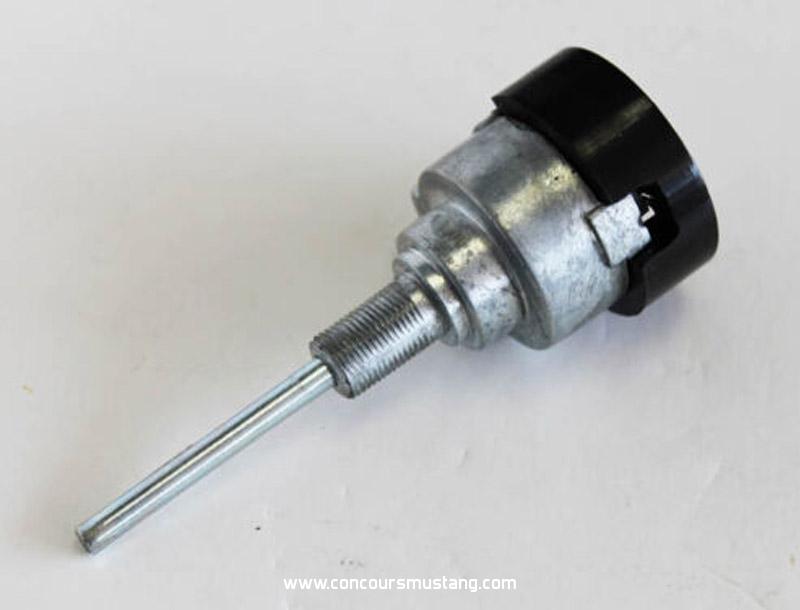

No the knob is not attached permanently to the shaft like the headlights but instead the shaft stays with the switch and comes out with it.
Though not an original - this represents the switch and basically how it looks when out
« Last Edit: January 11, 2020, 04:22:15 PM by J_Speegle »
