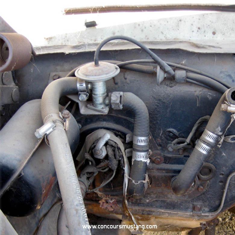

Ignore the creative build your own heater hose atttempt but here is a fairly early 67 San Jose shot to add to the collection
