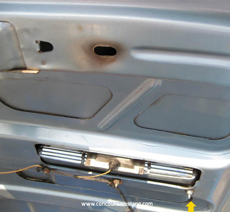

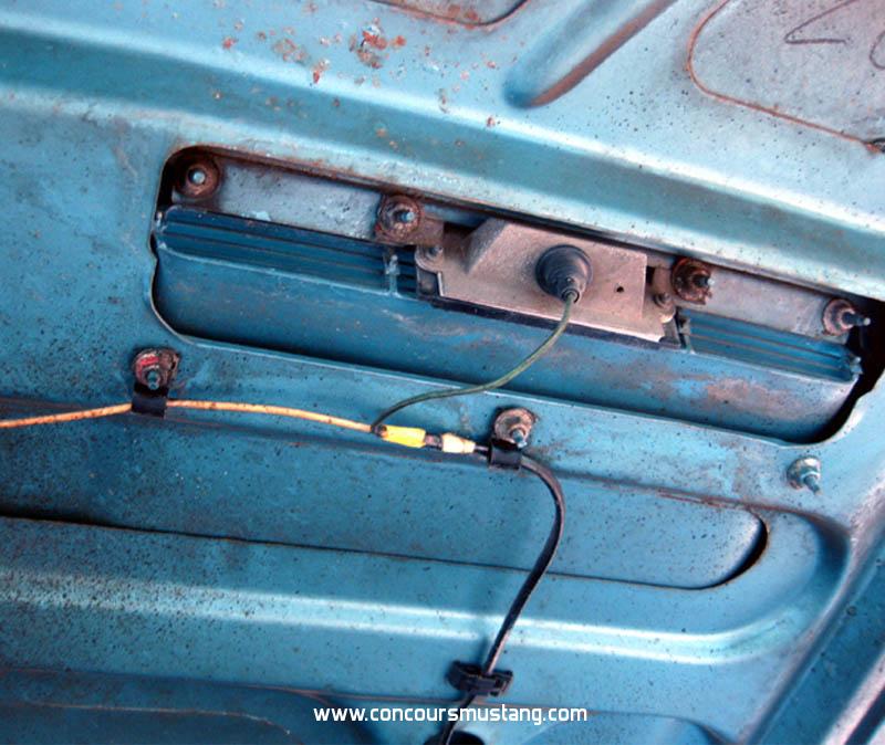

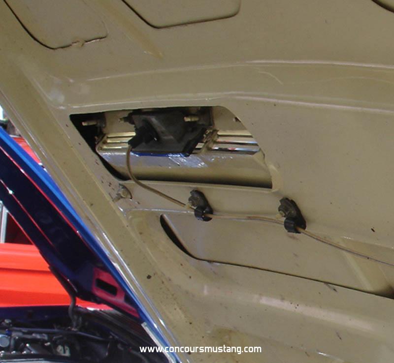

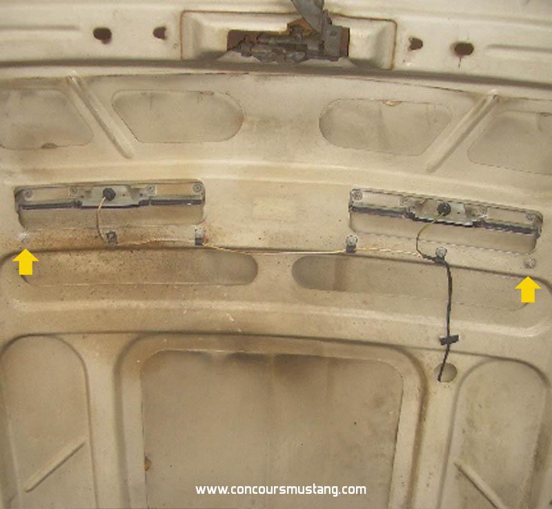

Marty of course I can only view pictures of these details from below the hood and have few to none from the top with the turn indicator bezels removed.  Based on this let me offer the following. It appears to me that San Jose likely, like the rear quarter panel extensions (end caps) installed the bezels in the hood and spaced them away from the hood some what with one nut installed. After painting the lens, wiring, removed what ever they were using as a spacer and the rest of the retaining hardware was installed and tightened into place.
As mentioned this would reflect what was being one and had been done elsewhere on the car and would result in having one retaining nut painted body color. Normally the rear outer one.  Looking closely many of my pictures show this pattern.  The next question would be when this started so back to the 67 pictures

Thanks - The end caps is another discussion. Have allot of examples to demonstrate that practice for all fo the production years at San Jose.
As for the idea of the bezels being in place with one nut I offer the following evidence. Have some others but the hardware is so rusty that any paint that would have been there is long gone since the plating is ;)
Some of the clearer examples. Had over looked this details when we've discussed and posted pictures of the wiring and hardware in earlier threads
8R10129x
8R12471x
8R12673x
8R13919x
