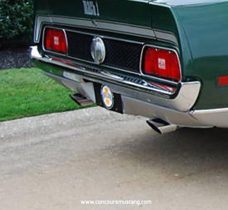

From the 429 Megasite.
Correct Exhaust Tip Positioning
We believe the positioning of the chrome tips shown in the photos above is the correct factory location. They are close to the valence cut-outs at the tops and sides of the tips.  Also, the length of the tip sticking out beyond the valence is correct too.

Offline Mwilson7
  • Posts: 21
Re: Correct Mach 1 exhaust tip placement
« Reply #3 on: August 18, 2017, 05:59:00 PM »
I didn't even think of checking the mega site!  Sigh......
The tip in the close up picture looks a lot shorter than my tips.  Looks like I have some work to do.
Thanks for the quick reply guys!

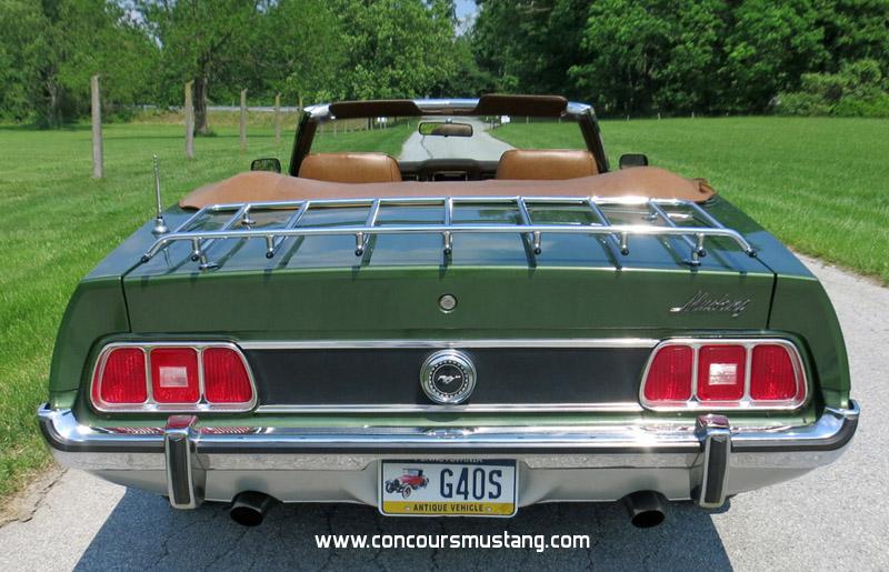

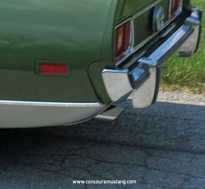

« Reply #4 on: August 18, 2017, 09:02:31 PM »
Couple of others - Unrestored cars
« Last Edit: August 18, 2017, 09:06:49 PM by J_Speegle »
Offline Mwilson7
  • Posts: 21
« Reply #5 on: August 18, 2017, 10:09:48 PM »
I was not aware that you could get the exposed tip exhaust on a convertible.  What package did that come with?
