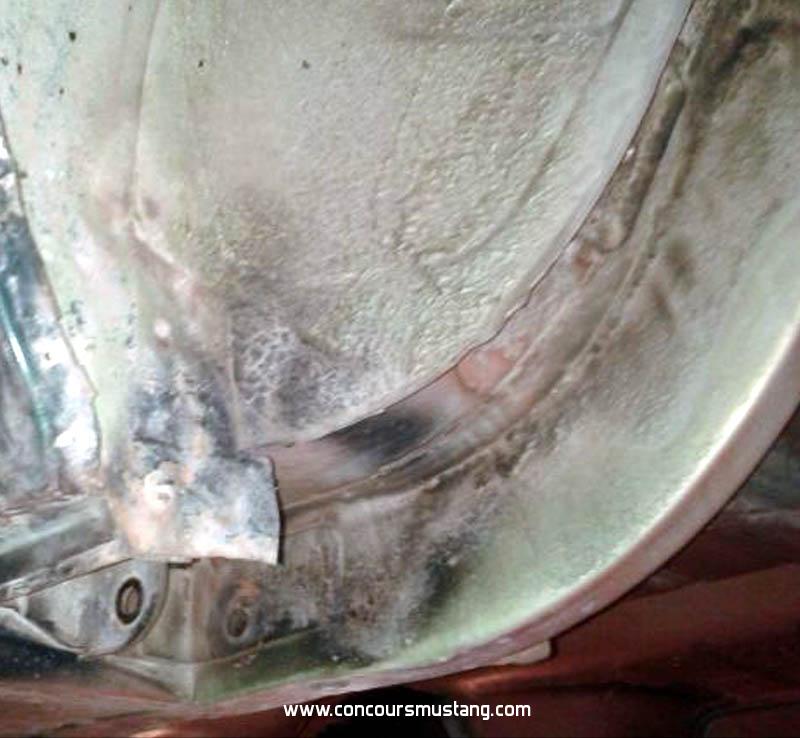

Hope this helps. Have plenty more - just grabbed a little of this and a little of that as I have a fair amount of examples. NOTE: please be aware that these are original old cars so often much of the lighter overspray is gone or has been cleaned off. In other examples later paint jobs or chipping can cover or have allowed the removal of some of the paint but you can fill in the blanks as you look at all the pictures in total

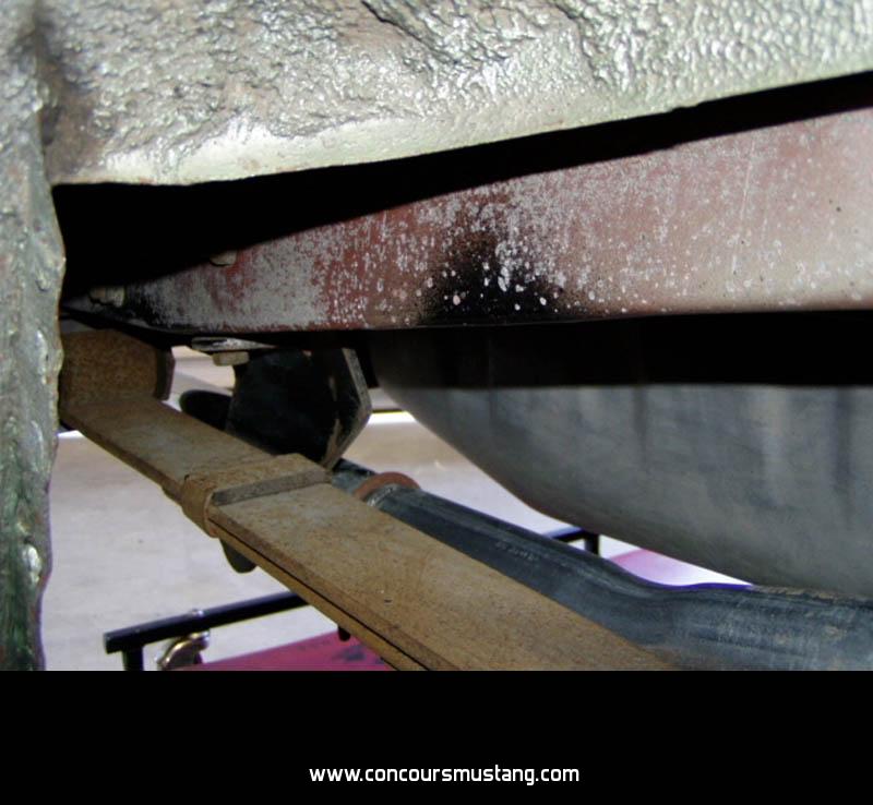

Applied at a greater angle - more paint (runs) on the close stuff - less overspray further in
Large amount of overspray behind the rear wheelwell on this example due to angle

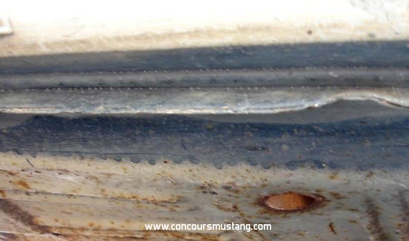

Example of soft edge on the outer edge of the black out - typical
This example a slightly sharper edge but still not tapped nor perfectly straight

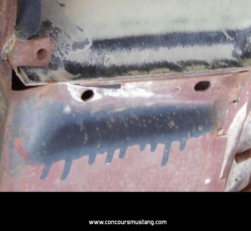

Angle these workers/painters used was not as great compare to some other examples above and below - producing allot more overspray on all the panels below
We see other high angle higher angle applications above in other pictures where the jet/gun was so close and the angle so great allot of paint built up on close panels reducing the amount and coverage of overspray inward on the undercarriage

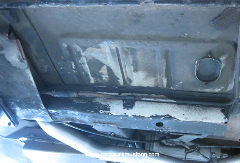

 As the spray gun or mounted jet reached the leading edge of the the rear wheel well and beginning of spaying again at the rear edge of the rear wheel well opening the paint the process produced "blow outs" on the surfaces behind and slightly above (in places) the pinch weld
Front/leading edge of opening example
Rear/following edge of the opening. Further back you can make out the overspray from the rear quarter panel pinchweld blackout on the frame rail. Much easier to see this detail in the second picture from the top in this post
Often it is found greater/larger than these examples

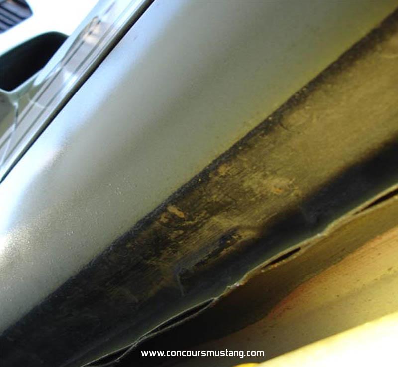

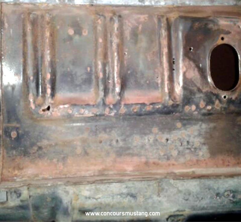

This pic:
shows color overspray onto the hard fuel line, rubber and bracket.
It doesn't show black over the color, although that could have worn off.
Did the owner say this car was original without a subsequent re-spray? Yeah, tough question.
Were the fuel line and other components installed prior to paint?
If so I need to install them prior to underbody color and blackout so they get the right amount of overspray.

« Reply #9 on: October 19, 2017, 03:52:39 PM »
If you noticed the repsray/or touch up  (likely years later) was applied and coated the lower edge of the pinch but they took no effort to paint the bottom of the rocker The frame rail shows IMHO the respray over black pinch over the factory body color. Guess I should pick a better example from the files and replace this one . NOTE:  Picture replaced with one that doesn't have a respray
No as mentioned earlier nothing installed other than doors, trunk lid, rear valance hung and rear bumper guard brackets

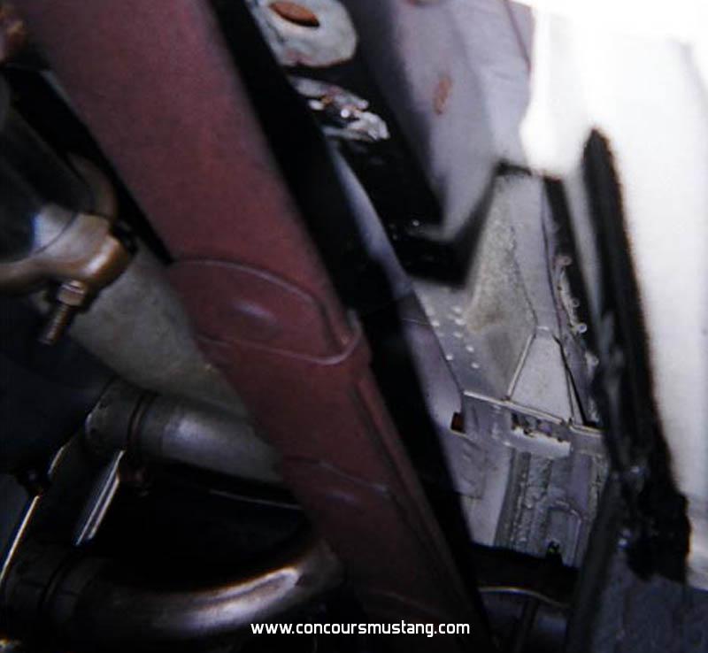

Here is the drivers side of and other example though someone has gotten under the car a bit and blasted some of the pinch weld black out away with some road grime with a high pressure washer. Glad they didn't do more or no telling what would have been left. ... but it would have been clean    ::)  Angle is odd and not great to show the difference of finish of the shadow left by the dolly. Its there just is dark like the surroundings but the difference in texture is noticeable
