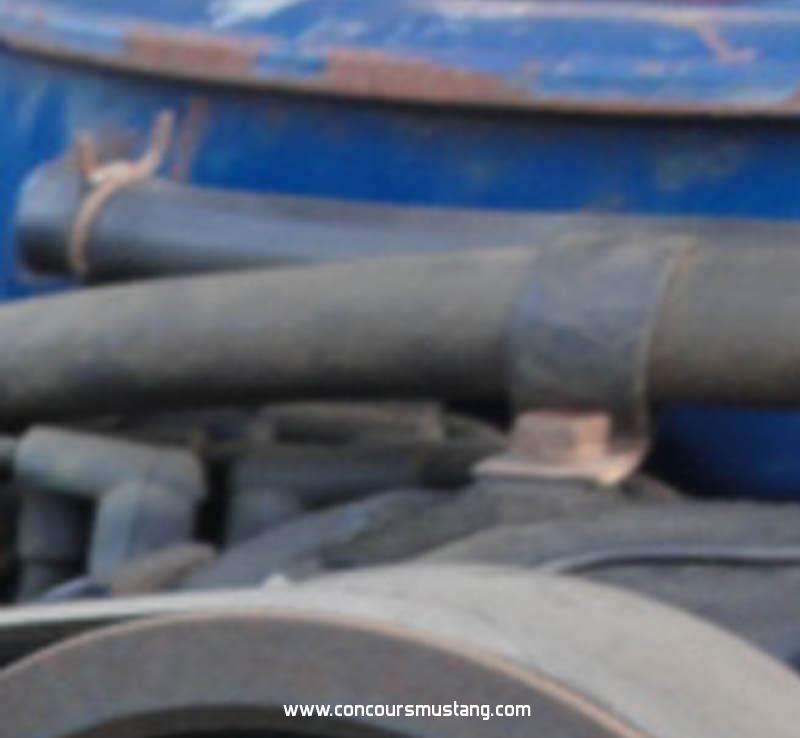

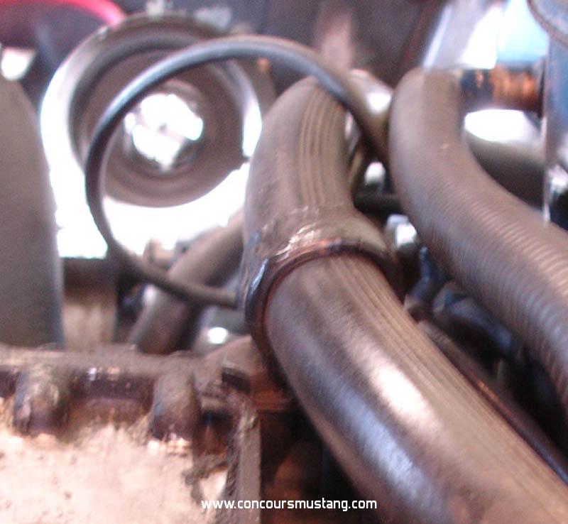

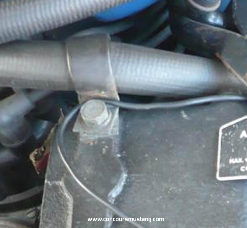

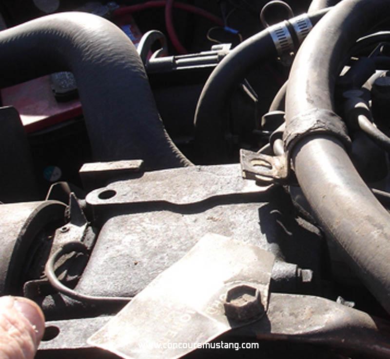

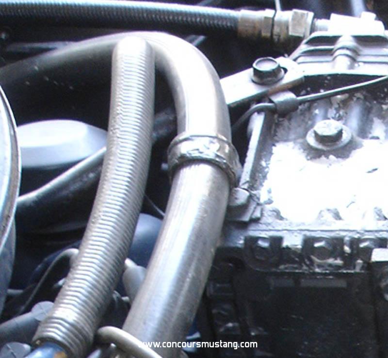

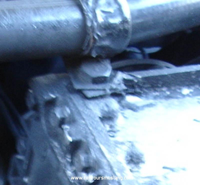

The 67 appears to be the same as the ones used on 66 Thermactor 1/AC cars. Looks like they were coated (like other AC application bands) just short of where the mounting bolt holes are, giving enough room to clear the bolt head and its rotation.
67 small bock
66 small block
« Last Edit: October 19, 2017, 06:29:09 PM by J_Speegle »

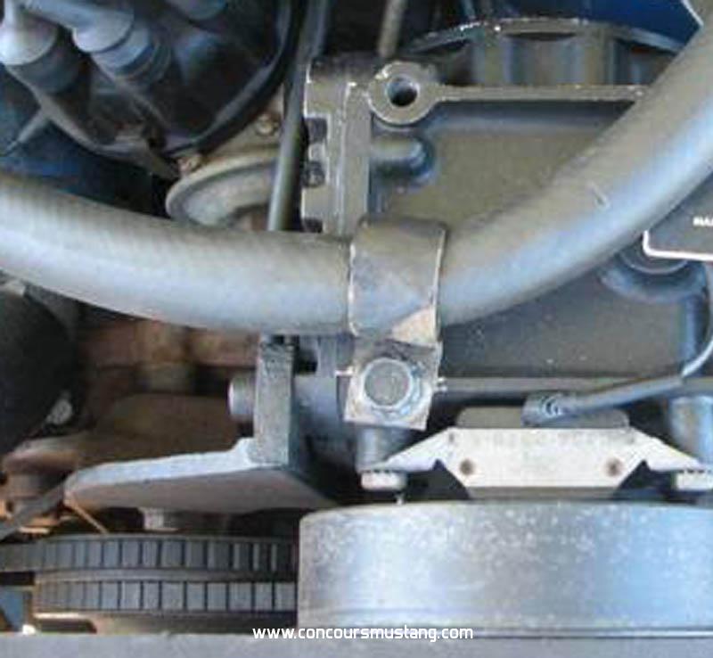

Jim, I wondered if it was overall length but the numbers do not seem to make any clear sense to me. After viewing and measuring an original, and if I understand correctly, this (your description) would then read "2 AND 45/64ths overall length" then? (slightly under 2-3/4"? ~actual measurement slightly UNDER 2-1/2" ~see attached picture) The loop inside the strap is very close to 1 3/16 inch diameter, so in my previous comment/question, I took a bit of liberty and "inserted the 'dash'" because that works within "my brain" to connect the "2" to the "fraction". Sorry to confuse things if I did.
The Borrowed one has arrived today and I am studying the dimensions and surface finishes. The metal strap (16/18 gauge steel .052" thick measured), if it were to be rolled out and laid flat on the the desk, measures 7/8 inch wide by 6 inches long. (I cut a 7/8ths inch wide piece of paper and wrapped around the outside of the metal to determine the overall length of the strap) The 90 degree Bend in the loop, is also approximately 7/8th of an inch from the end. The holes measure very close to 1/2 inch diameter.
Inside of the loop, there was a good stretch of the rubber coating. Underneath the coating, it appears to have a green tint to the finish. Everywhere else looks to be over natural steel with some signs of having been painted perhaps.
I have attached some pictures.
« Last Edit: October 20, 2017, 03:17:44 PM by 67gtasanjose »
Re: 67 289 Drivers Side Thermactor hose to AC pump Loop
« Reply #5 on: October 20, 2017, 02:48:08 PM »
Believe the metal was plated like the other AC straps we find and the green is likely a reaction between the rubber coating that plating. Easy to see, now that you have one, where the coating stopped and started
