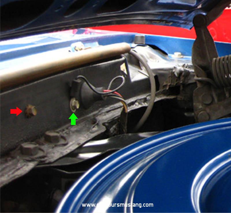

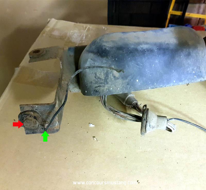

To illustrate Eds comments
Red arrow is the mounting screw for the bracket (someone must have placed what was left of the ground wire there so not to lose it)
Green arrow is the grounding wire - goes to a separate grounding location on the face of the cowl
