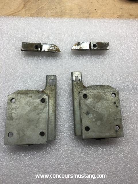

Hi, any difference betwen 68-69 fold down seat latch ?? Look pretty close !
Mustang Fastback 1968
289, 4 speed

Aren't these both reproductions?
Will see if I have some pictures of originals to compare
« Last Edit: November 07, 2017, 10:21:17 PM by J_Speegle »
Yes in reproduction ! Both the 68-69 latch are reproduction .

« Reply #3 on: November 07, 2017, 10:54:33 PM »
The same fold-down seat latch pair were used from 68 thru 70 as factory installed items. They were replaced by the 67 pair for service.

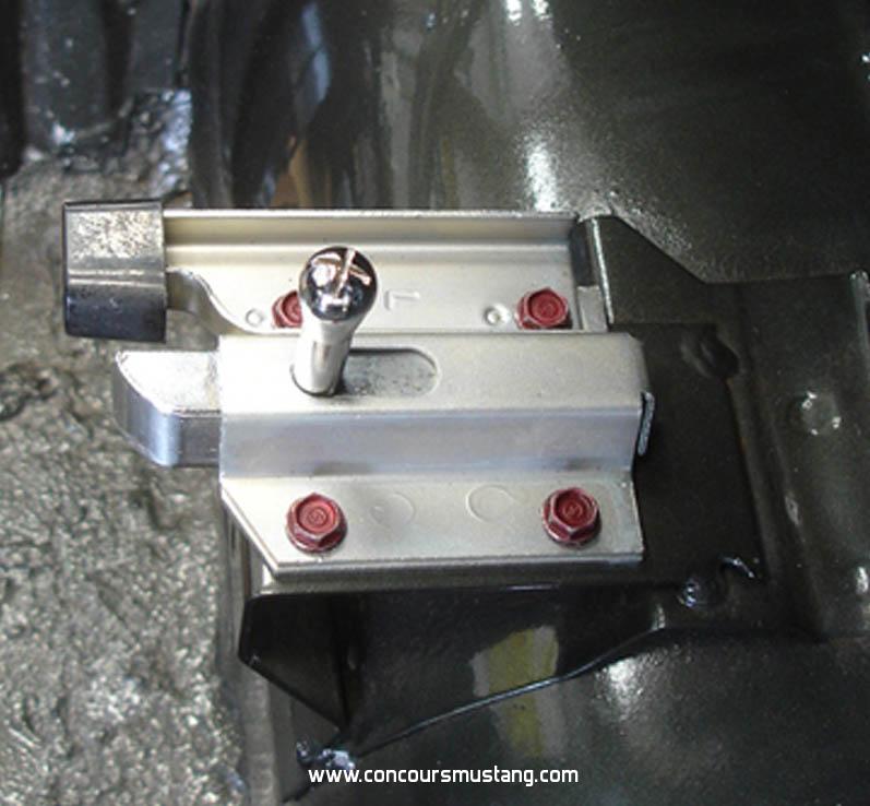

« Reply #4 on: November 07, 2017, 10:58:09 PM »
69 versions

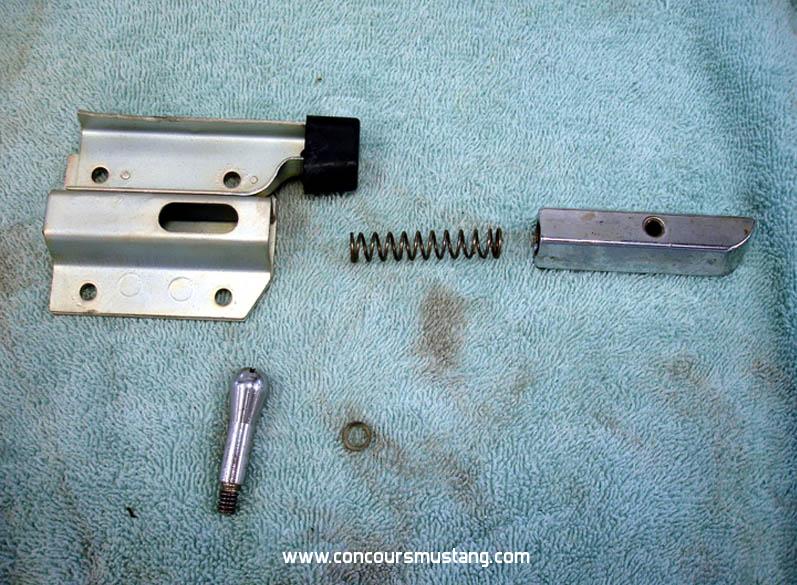

The 1968 version has a two piece plunger bar. The visible end is chrome.

The length of the knob for 69-70 was shorter.  The rest of the latch was the same.
