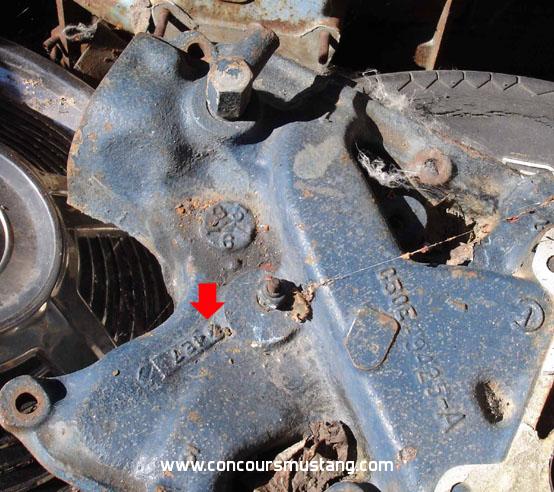

Figured we would start small and focused study then we can move to later years and other engines once we get this step addressed and if it bears any fruit
The question - Is the assembly date and assemblers initial stamped on the small protrusion at the front drivers side of the block where the head attaches the assembly date of the short block or the completed engine?
For years we have taken it to mean the completed engine but let's see what the findings suggest and discuss

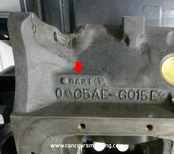

To collect information we need at least
1- Engine block casting date
2- Assembly date stamped on the small extension/protrusion

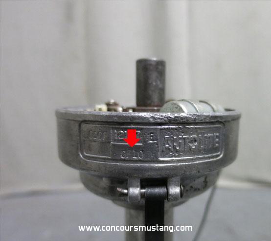

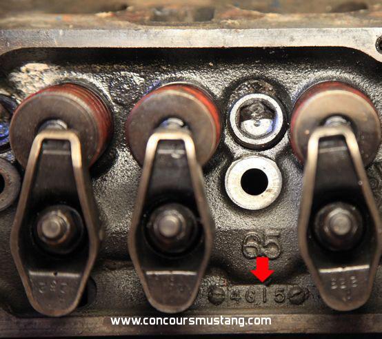

3- Casting dates of the heads, intake, dist, exhaust manifolds believed to be original to the block

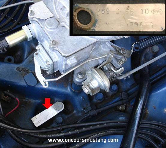

4- Engine ID aluminum tag information
The findings may not be as defining as other surveys since individual items could be cast before and installed after if that was what was done.
Lets see where this leads us
Thanks for viewing and considering participation

Block casting 6B19 -            19th Feb 1966
Heads are both 6B25 -         25th Feb 1966

Distributer 6D7 -                  7th April 1966

Engine ID aluminum tag information:
289 C 66 10
5-M E 235-S
