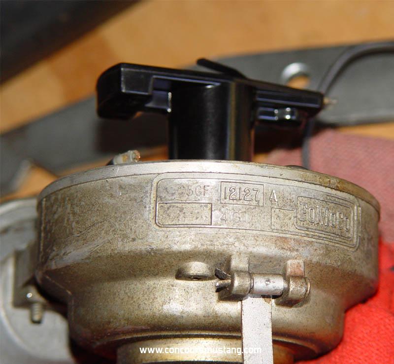

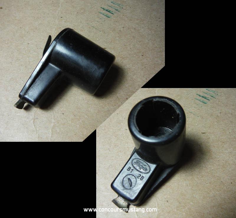

Re: Details on Original Distributor Rotor B7A-12200-A
« Reply #8 on: January 04, 2018, 08:44:56 PM »
Went out the garage and took a couple of pictures
Had a case of these - guess they are all gone as this one came from a dist repair kit
Offline sanluis09
  • Posts: 67
« Reply #9 on: January 05, 2018, 02:32:23 PM »
Hi Jeff,
Thanks for the pictures.... the first one is the rounded shape and the second is the one with the shape we already know....having found the rounded one also in your garage, does this means that both shapes could be correct?
Thank you,
Luis
« Last Edit: January 05, 2018, 02:41:18 PM by sanluis09 »
1965 WW Hardtop, 289-2V, 3-speed manual transmission. Unrestored. Assembled in Mexico on the time frame of: Oct 64-Feb 65.
« Reply #10 on: January 05, 2018, 03:13:11 PM »
Its correct for something by not IMHO for your application. I own Fords back into the late 30's so there is often many different parts for many different applications. Just wanted to show details for both of the items you had asked about
  • Posts: 9526
« Reply #11 on: January 05, 2018, 04:15:55 PM »
The short rounded rotor is apparently the earlier version . It will work but is not historically correct IMO. As I said before it was used on earlier engines . I personally have seen a few on pre 65 SB distributors with the oiler caps .  If you are not sure what the oiler design distributor looks like check out 2-38 of Bob Mannels book. Interesting to note The Mannel book does not cover the earlier design rotor.
