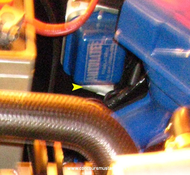

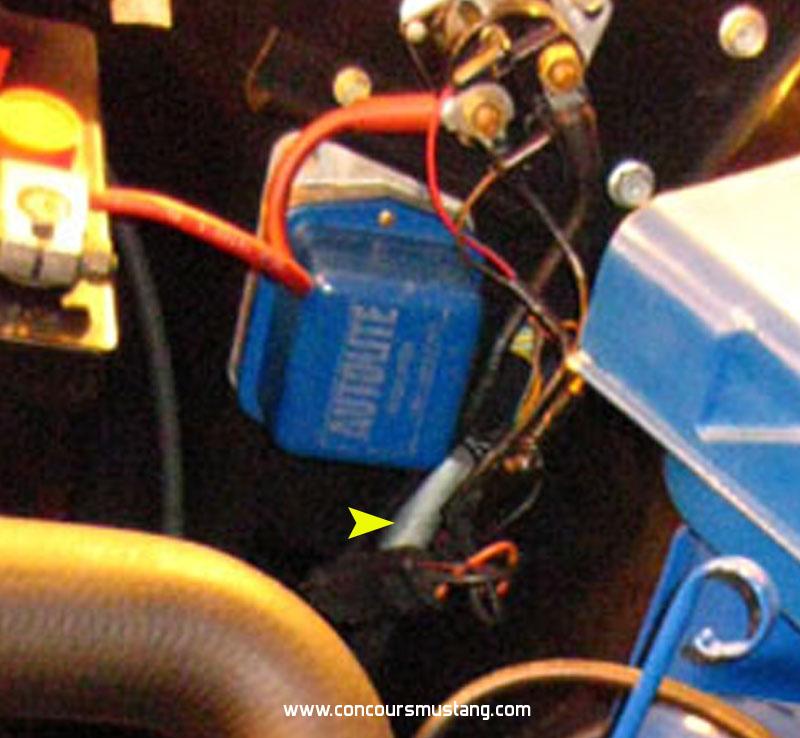

Re: 1969 Dearborn Radio Suppressor Type and Location
« Reply #3 on: January 15, 2018, 02:45:21 PM »
Sorry for the poor close ups. First two I ran across
Jan car
July car
« Reply #4 on: January 15, 2018, 03:52:33 PM »
Thanks Jeff.
« Reply #7 on: January 15, 2018, 07:06:41 PM »
The Shop Manuals have a lot of useful information.  Brian
Great example showing how Ford wanted it and my pictures showing how they were installed in real lift.
Thanks Brian
