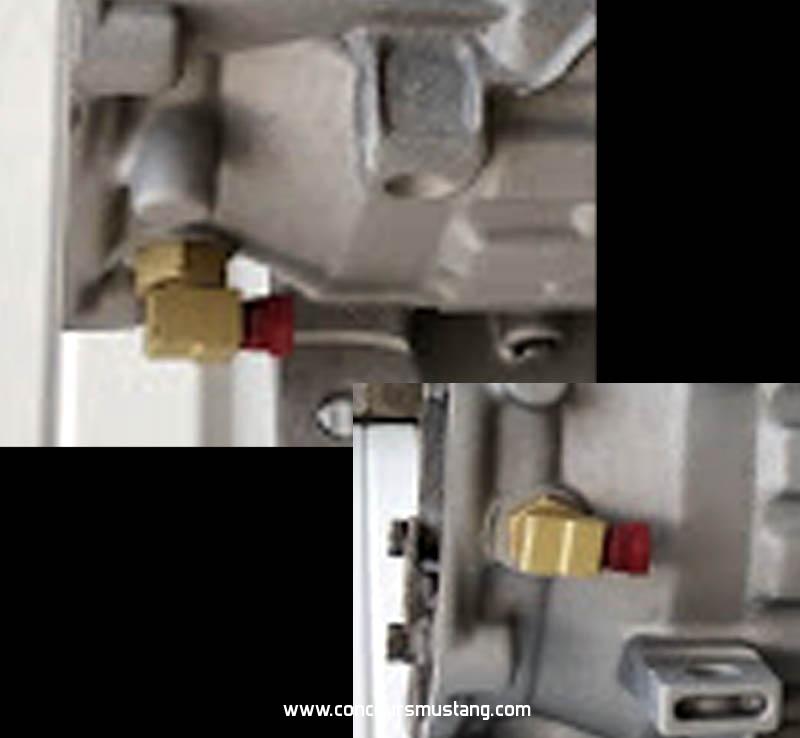

Hope this helps  Picture is a composite from Brant's tear disassembly of  a unrestored 67 GT500

Bill,there is a special 90 degree brass fitting used . I believe my picture file is too large so I am having trouble loading. After 4 attempts I can't figure out how to reduce it.  I would be glad to send you a picture if you send a email address to me in a personal message. Sorry I couldn't post so others could see.
Bob's resized photo.

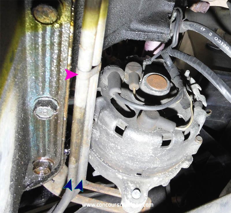

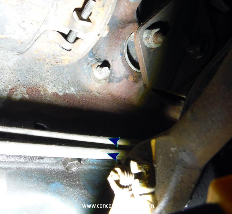

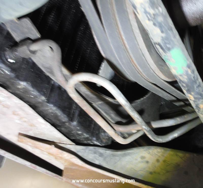

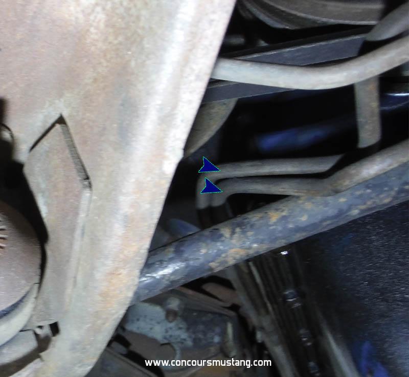

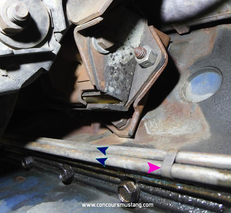

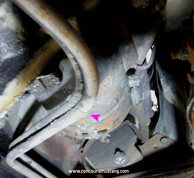

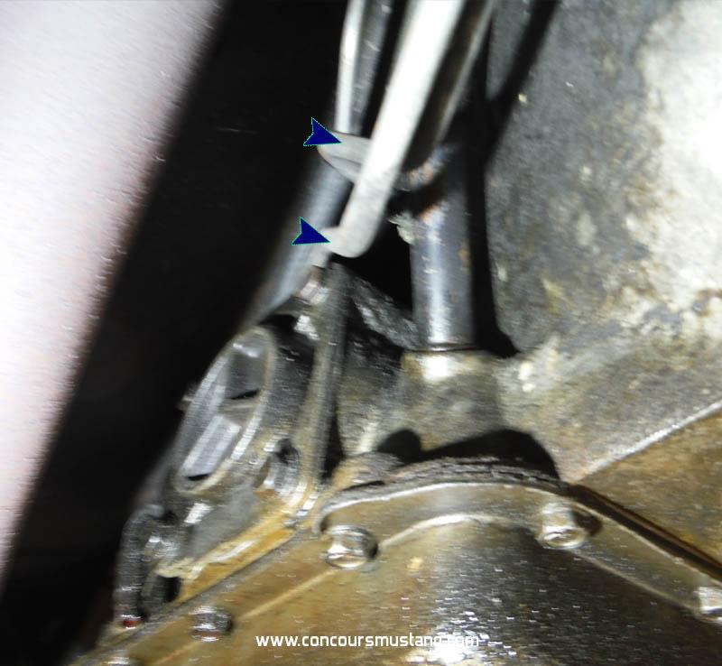

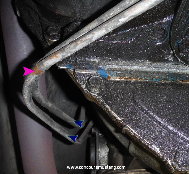

Here are some of the pictures I took last week. Covers pretty much from radiator to trans though there are some gaps at the very rear where the lines go into the trans due to other things in the way and lighting
Hope these help
Purple arrows - band/C clamps
Blue arrows - identify the transmission fluid lines
TL-1
TL-2
TL-3
TL-4
TL-5
TL-6
TL-7
TL-8
Re: 1967 C6 Cooler Line Fittings at Transmission
« Reply #10 on: February 01, 2018, 05:25:27 PM »
................. I wouldn't think the only points securing the line would be at the fittings...but I am wrong more than I am right, so hopefully someone can help.
You would think not but there are a number of examples where they were pretty much suspended much of their length. Sure many of us have dealt with "buzzing" transmission lines.  a quick twist or realignment often fixed the issue - at least for a period of time.

On the 67 FE the lines are connected to the fittings only front and back and not connected to the engine block.  The two lines are typical held together with a small metal clip in two spots . These spots can vary some . From various observation one typical spot is where the lines straighten out after wrapping around the starter and another spot farther forward just before where the lines pass the front of the oil pan .
