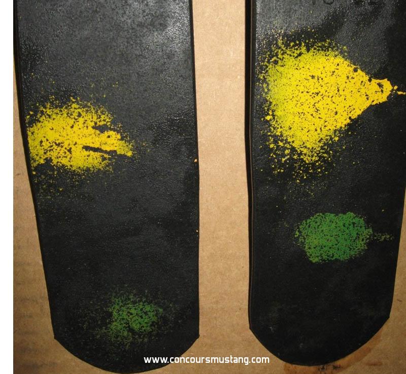

As expected. The GT's that year (K and A codes) share the rear springs with one another and with Shelby's
Typically would be marked with one green and one yellow mark, short leaf, near the end of that springs on the rear end of it as installed in the car. Marking is only on that leaf. Front to rear yellow first then green was pretty typical. for your time period (since we lack any original markings) I would apply the marks with large spray daubs/dots (free hand - no masking or using Dixie cups  :)

Jeff,
Can you tell me what paint daubs or stripes would have been on my Kar and where?  A picture would be helpful.  My leaf springs are C4ZA 5556S.
For a car similar to yours (1966 GT, 6T09K13, Born 23 Oct 1965) I would suggest the spray dots/daubs as shown above. Looks like cars about a month-two months later started showing up with the other style of marking
