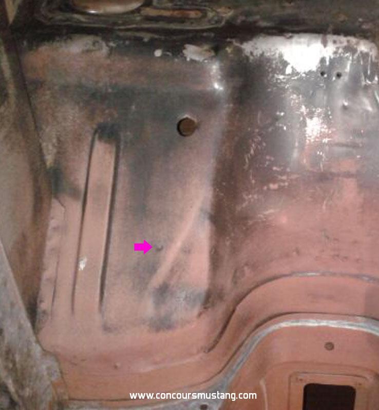

On the 390- 4 speed car speedo cable I have read in multiple places the routing and clips used.  I have the manual page which shows the clip at the passengers side toe board area, but my floorboards lack a hole in that area, other than the AC drain hole.  Can anyone help me on where to position a hole in that area for the appropriate clip.  Maybe using the AC drain hole as a reference point.
David - want to confirm that your working on a 67 year model/Cougar?  Didn't include that in your post so want to be certain before I start looking for references to see if I can help with some pictures ;)

Yes it is a 67 model year Cougar.  It had a scheduled build date of 10-28-66, so early production if it matters, and a S-code.  Several items dictate it was indeed earlier off the line.  Has the vac can for AC inside under the hood hinge.  The earlier style headlight door actuator, and the vac line routing for the AC controls are the early style where they lay in the channel under the glove box.  Oh and no buck tag, just to name a few.
Anyway, I see what looks like what might be a spot where there was a hole, hard to tell.  Seems like it stretches the cable a little too much to try to get it there.  It also seems like it would be in an odd spot, as the spot I am referring to is in a reinforcing rib molded into the floor board. The picture examples I have seen of Mustangs with 4 speeds (various years) seem to place it closer to the radius where the flat floor meets the tunnel.
PO could have welded it shut not knowing it was for a speedo clip.  I know he did a little patch work in DS floor pan area.  Or maybe it was never there.  Need to get something there though to keep the cable from ending up against the H-pipe.  Car is far from being concourse, but I want to do it right I guess, or as close as possible.  I have already talked to Scott over at WCCC, and he told me they didn't have any examples of 4-speed cars in the yard to check it out on.

« Reply #6 on: April 16, 2018, 02:34:01 AM »
I did have that in there, but I must have edited it out for some reason.
Try this location ;)

Thanks Mr. Jeff.  Probably will look for a dimple there later today.  If I can't find it, is that a current picture of a project your on that you could pull measurements for me from say the centerline of that rib over, and from the center of the AC drain hole down?
David
Not from a current project and don't have a 67 at home at the moment. Center line appears to be outboard from the center line of the AC drain hole
