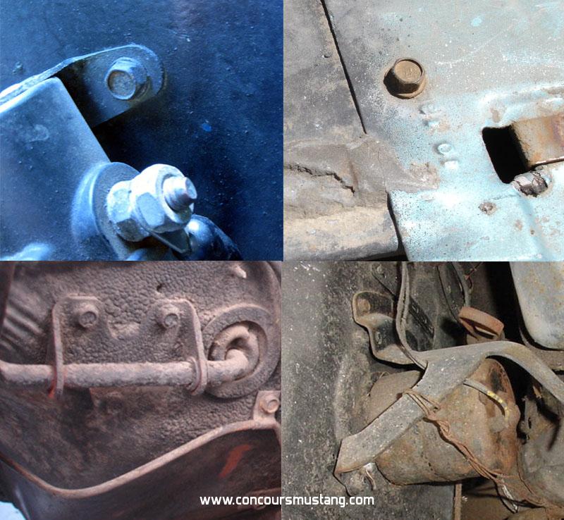

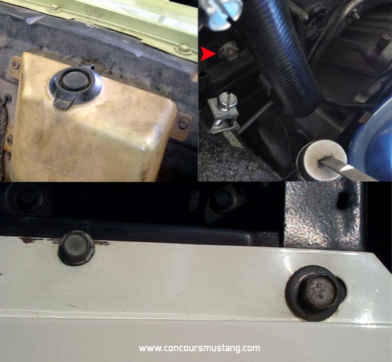

« Reply #3 on: March 03, 2018, 07:40:38 PM »
A screw that was used in dozens of locations and head markings that were often found through out the production year. Some other head markings are mixed in also but this appears to be the most often found.
Here are a few locations I found at the front of the car in a quick scan of later San Jose built 67s

I looked over the car for screw hole locations. Came up with a few :solenoid, volt reg., ac condenser (missing), washer tank (missing). The other items Jeff pictured on the firewall are still on the car.  I don’t see a shield on the heater motor.  I did just remember the heater control valve might have been mounted with them too. I did have a 3rd hole by the voltage regulator but it looks like something aftermarket.
I see in Jeff’s picture a diamond head marking on the splash shield. I’ll label them for the splash shield and there seems to be 3 holes there.  I’m sure I will be short some on assembly.

« Reply #5 on: March 03, 2018, 08:25:17 PM »
Just for your use and others viewing this thread. All of the pictures I posted had the diamond head markings except the throttle crank but have that markings on other examples from the same plant.
