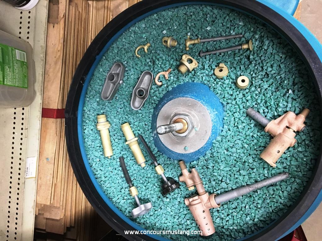

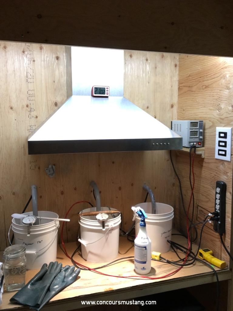

This is the setup I built to plate parts less than 21 square inches.
I know sounds funny, why 21 square inches? Because that is the limit of my 3A constant current/constant voltage power supply. Sound technical? The power supply is key to obtaining excellent results. You cannot plate with a car battery or cheap transformer. I would highly recommend having a plating station when attempting a concours restoration. My concern wasn't so much about losing parts or paying for expensive plating. I just wanted to understand what the process was all about. I also looked around on this site and only found discouraging comments. So I just decided to figure it out for myself.
It takes some practice to get the finished product just right. One thing I should mention is this is a science not an art. Surface area being plated is calculated using formulas designed for common shapes like cylinder's and squares. Sometimes you have to calculate the area using several formula's (all available as online calculators)
Surface preparation is key to having the finish look right. That is why I also invested in a vibratory tumbler. I already own a media blasting cabinet.
The process goes like this: Degrease, media blast clean, tumble finish, plate. My setup allowed me to finish cad/zinc as well as yellow and black chromate. The use of chromic acids(yellow and black) as well as hydrochloric acid require the necessary PPE. A full face respirator with acid cartridges as well as the fume hood is a must.
Additionally, access to a clean running water source is highly recommended in case of an acid spill. Temperature of the tanks is crucial as well as the ph level of the plating tank. Guessing will lead to erroneous results. I can't stress this enough, this is a science not an art. Follow the instructions and practice. Keep notes about every attempt and after a while it seem easy.
