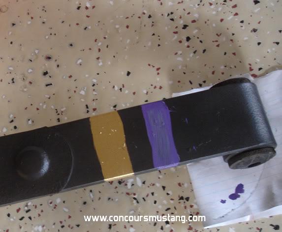

Front coil springs were likely - 1 Gold and 1 Pink stripe. Suggestions as to how they were marked can be found in other coil spring threads and the article mentioned below. This will help with direction of drips and splatter often produced during application.

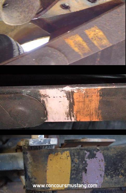

Rear leaf springs were likely marked C9AZ-5556-G  with stripes of Gold and Violet
Bottom one in this example
And a restored set of markings. Have seen them in both order from front to back. Just happened sometimes
Information obtained from factory buildsheets and pictures of unrestored cars
