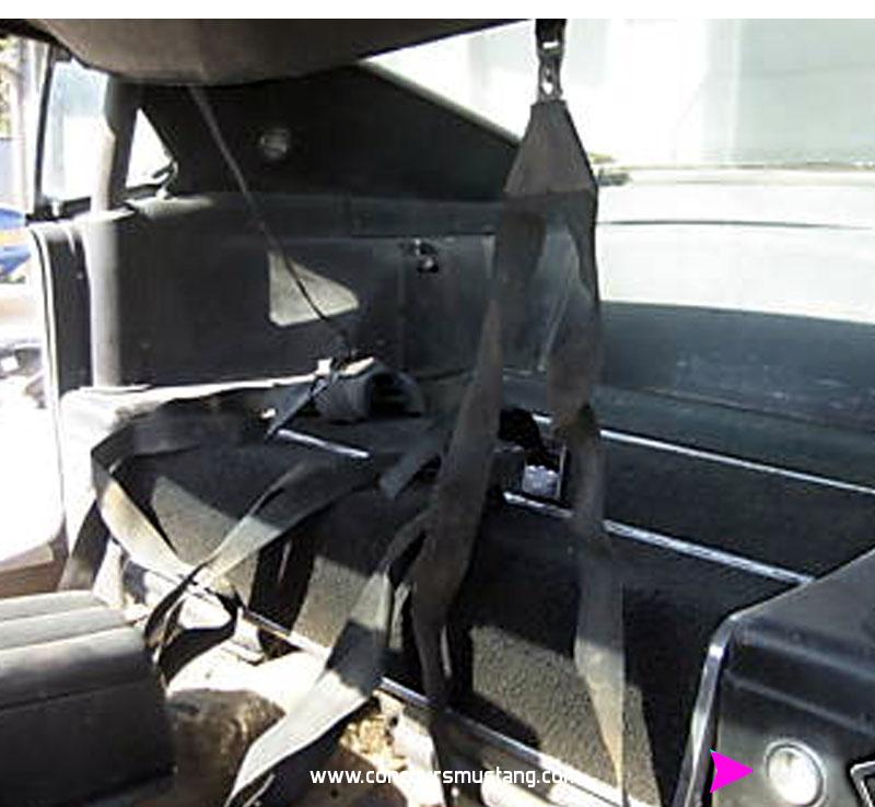

Did all 69-70 shelbys fastbacks have two courtesy light on either side. Typically all got qtr sail panel courtesy. I recently noticed a few shelbys had courtesy light down on the front facing surface of inner quarter panel panel. Was it factory, dealer installed or self installed after the fact? Was it done on early 69 shelbys up to a date. My 70 350 does only have courtesy light in the typical qtr sail panel. I will check to make sure either way. Just curious that's all. I can supply a photo if needed.

I thought the light on the lower inner quarter was only for convertibles as they do not have the sale panels to mount the lights on? My 69 GT350 FB only has the one pair in the upper sail panels, and I have not seen any other 69/70 fastbacks with them in the lower location.

Early 69 production thing for fastbacks
Dropped from production pretty quickly

« Reply #3 on: February 20, 2018, 09:45:14 AM »
Jeff,
Thanks. Make sense since the photos of shelbys i was looking at were s/n less than hundred. One thing to note the wiring diagrams in the shelby supplement include those courtesy lights.

As one would expect since those were produced ahead of time so they could be out for service needs.  But this can sometimes cause issues since they don't always reflect how the cars were built

There is only one version of the Shelby supplement to the 69 shop manual. There are two different printings that are slightly different color paper covers but the information within is the same.
That is a neat light. never saw one of those before. Learn something new everyday I guess.
