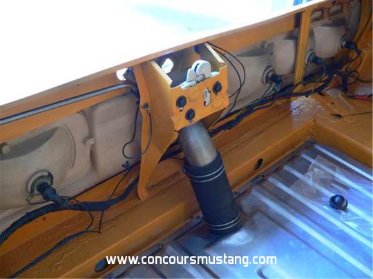

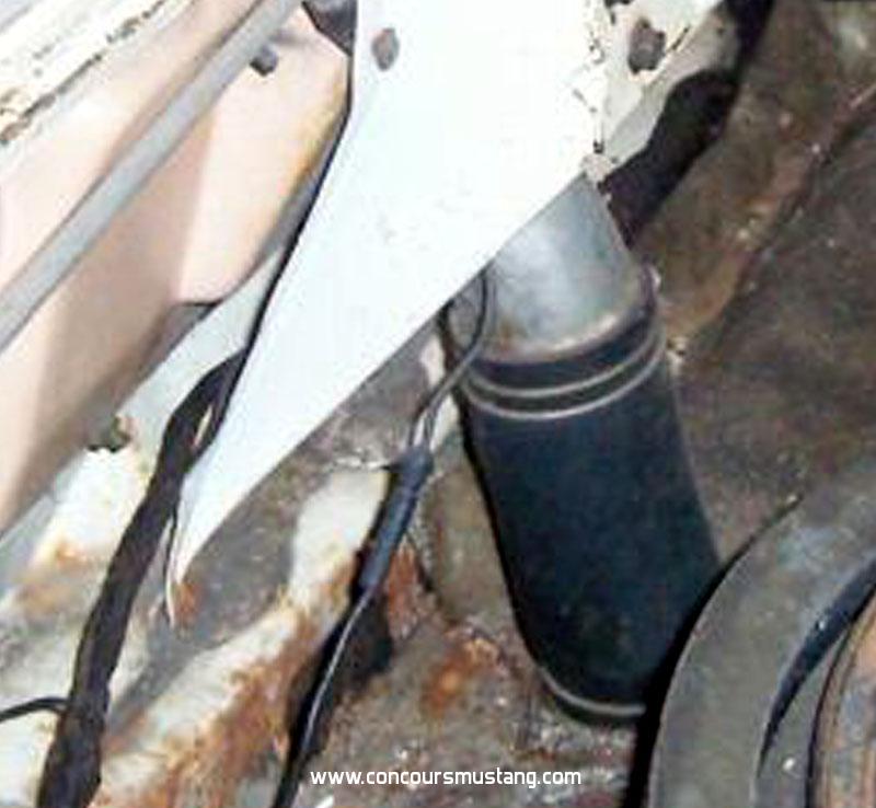

Also, it is possible that I do not have the original rubber hose that goes between the filler and the tank, as the one that came with the car is an inch or two longer than the one I purchased from NPD, which states it has the length of 4 3/4" and is smooth rubber which looks to be more like the one I have. There is also a Scott Drake version and is being listed as being 6" long with stripes, but a search here seems to indicate the "cloth" type texture is incorrect and may be more correct for San Jose built cars.
think the threads that you have found were focusing on 65-66 or at least early cars at San Jose. Be careful at mixing years together when doing your research.
Here are three pictures of 69 Dearborn filler necks. Two from Shelby's and one from a Mustang that I hope help in some way
Last Picture removed
