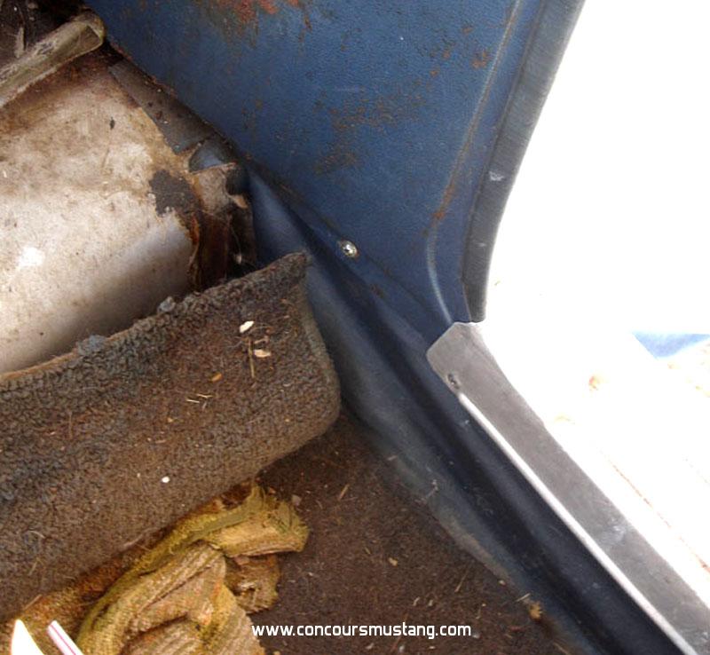

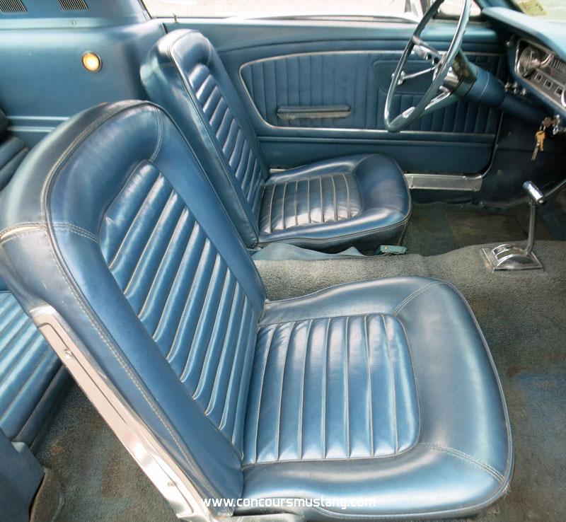

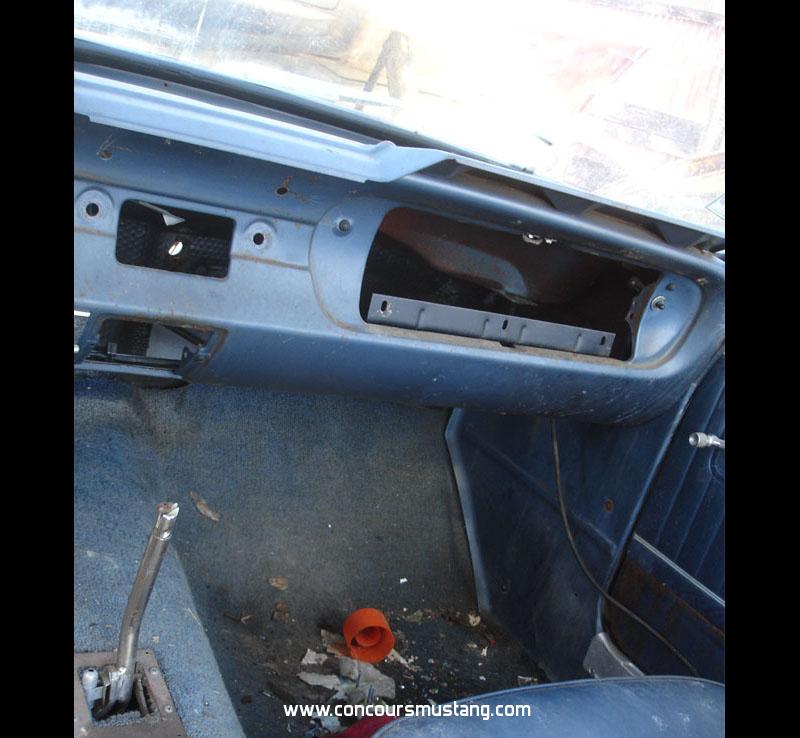

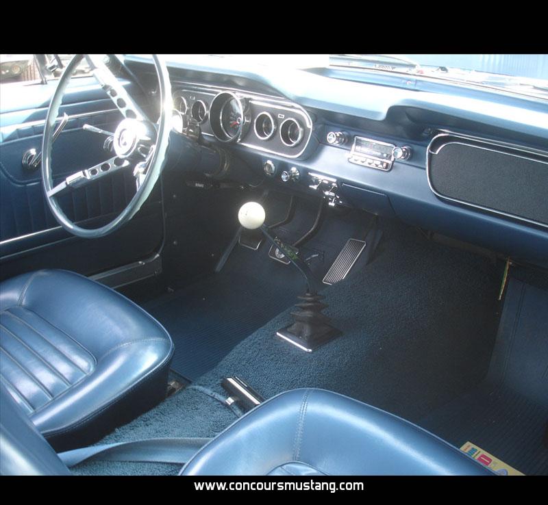

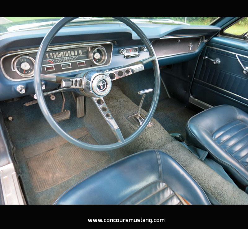

« Reply #2 on: May 16, 2018, 11:30:34 PM »
Couple more

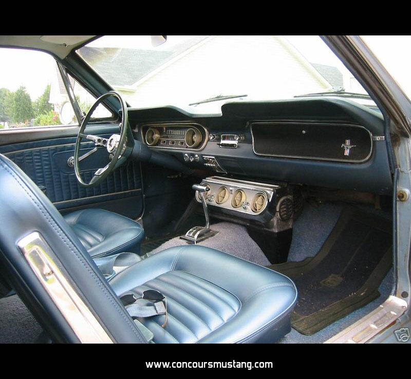

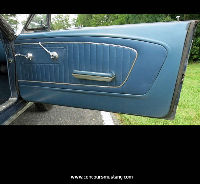

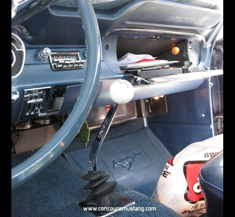

« Reply #3 on: May 16, 2018, 11:37:51 PM »
Here's how mine came out.  No it's not completely concours but close
