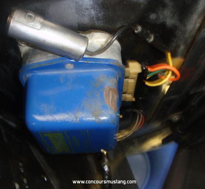

So the routing should look like the attached photo at the voltage regulator right?  Also, does the detached ground wire in the photo get bolted to the bottom of he voltage regulator or somewhere else?

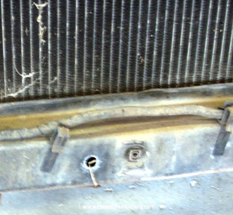

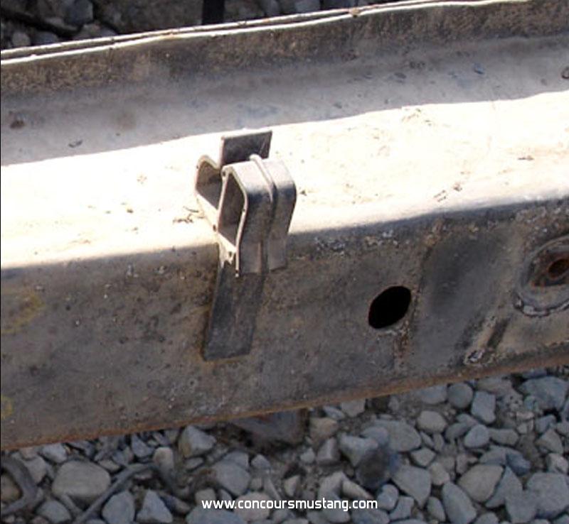

Is the voltage regulator connection facing toward the radiator?
Did you try the search feature?  Using the words "68 San Jose unrestored pictures" I found the following
Picture E2
http://www.concoursmustang.com/forum/index.php?topic=6385.msg36097#msg36097
Reply #2 picture eight
http://www.concoursmustang.com/forum/index.php?topic=11031.msg65949#msg65949
And an additional example NOTE: Service replacement voltage regulator so some details/markings do differ from the other two posted above
http://www.concoursmustang.com/forum/gallery/10/6-190518154039.jpeg[/img]]
Also, all of the connections for lights and horns are in front of the radiator support outside the engine bay correct?

Thanks Jeff.  I think I was being to specific with my search terms and didn’t pull those up.  The two photos you posted are perfect!
