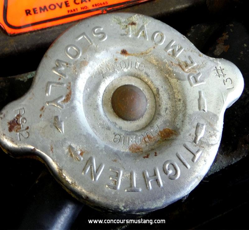

Revisiting this post.
Here is another picture of that cap - what was found on that late San Jose example, with the contrast adjusted a bit

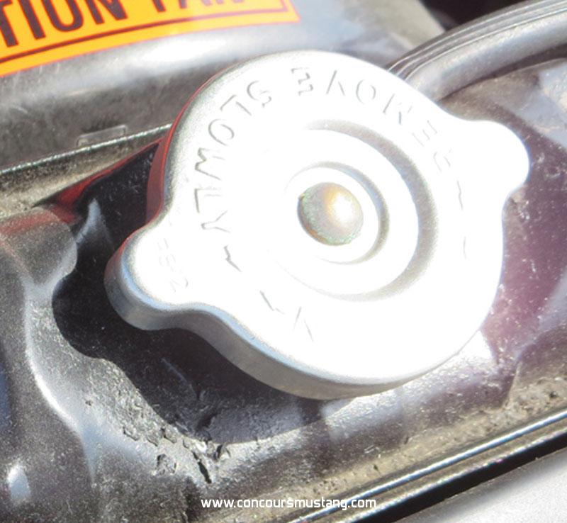

From other examples
7R113xx Very early SMCO example

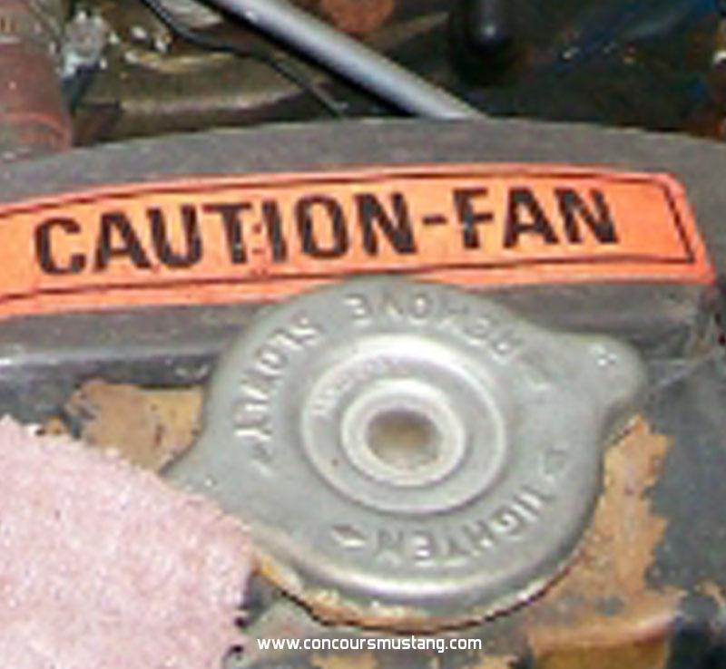

7R178xx Autolite

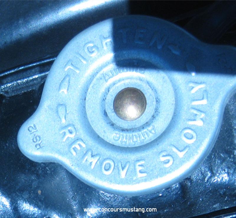

7R1883xx from earlier thread

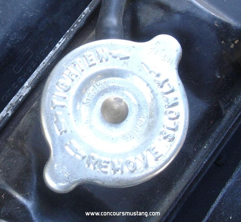

7R1977xx not yet posted in its own thread but from the same time period

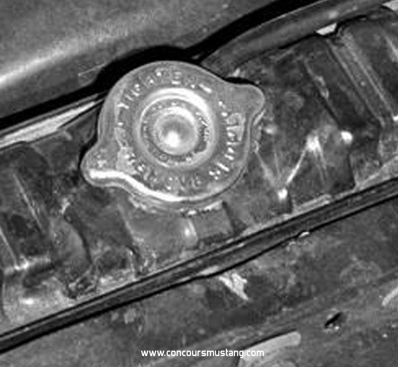

7R201xx Autolite example

when looking closer to the pictures that Jeff posted it seems that the initials 'RS-12' and '#3' must been placed vice verse (for the first picture)
but are placed correctly regarding to picture 5, with a slight detail that the initial 'RS-12' should be rotated 180°.
Just an observation, not knowing at all if it makes any difference for judging  ;)

Kind of recall something about the "flopped" location of the #13 and the RS-12 but can't recall what we came up with in the past. As far as judging - not really the focus - more what was correct and originally used ;)
