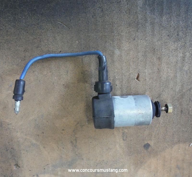

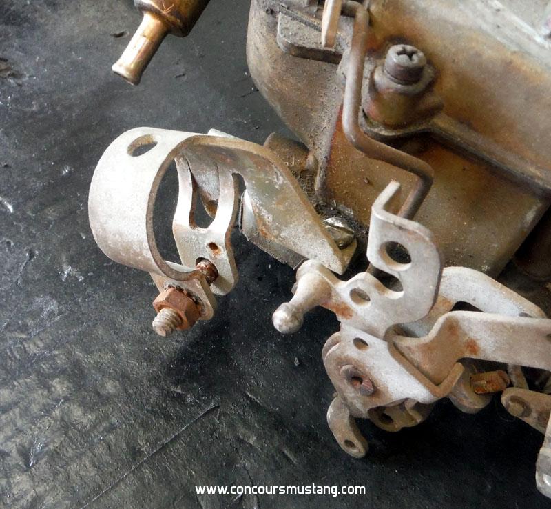

You also have an idle solenoid that was originally attached to the carb to keep form "dieseling" or "running on"
Retrofitting it to a Holley might be a "fun" task
A couple of pictures of the bracket and solenoid for that application
Ignore the arrows - original picture used in another thread here
