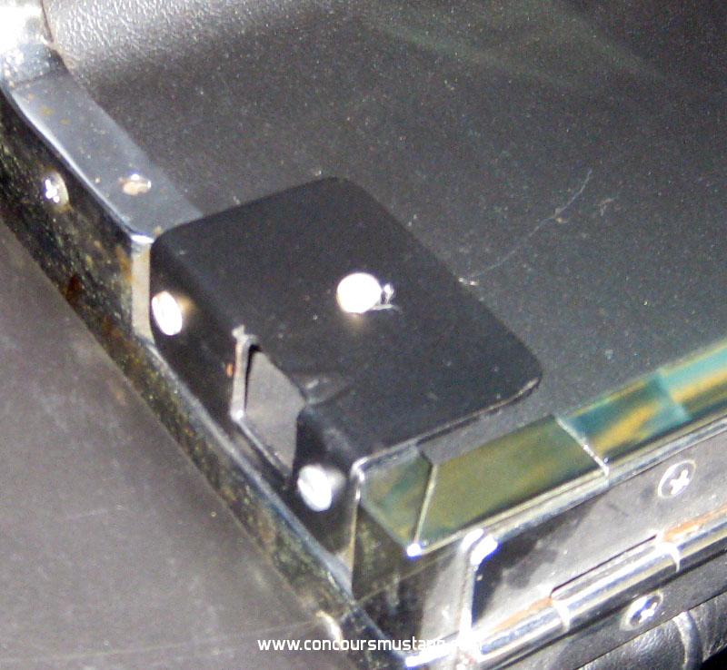

This is what was on mine.  The machine screw is #8-32

Thanks for the replies. I a had one of the machine screws in mine as well, with the other side missing. I assumed someone messed with it before and put the machine screw there incorrectly. Looks from John’s picture like it is the correct screw there. My car is a Dec 22, 1966 Dearborn car.
