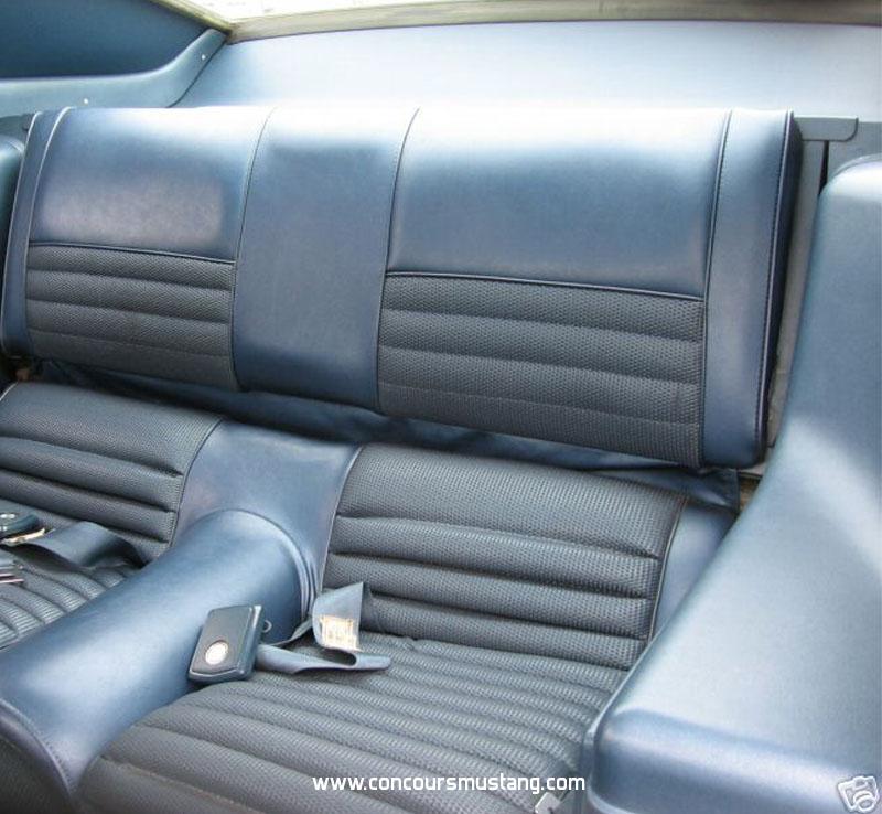

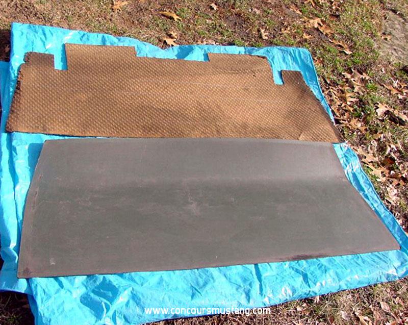

Dealer installed rear speakers were not very popular. Under powered and expensive when compared to all the aftermarket speakers available at the time. You would use the substructure as a guide to where the cut outs were.
Originally they were dyed/painted on the visible (top) side to match the interior coloring/pattern. Don't think the waffle pattern insulation is made or available any longer - at least I don't recall ever seeing them except for used. Never recall seeing any "dimples" and never any holes that were prepunched/factory

Thanks Jeff. I found this insulation which claims to be concours correct: https://www.themustangshop.ca/product/17091490/658472
It's hard to tell from the picture but it doesn't look like a waffle pattern to me.

Not the same material, thickness and the replacement is a jute with no real stiffness where the original was like (in strength and handling) like a thin cardboard.

Sort of a Masonite (pressed saw dust) board like the package trays on coupes.
