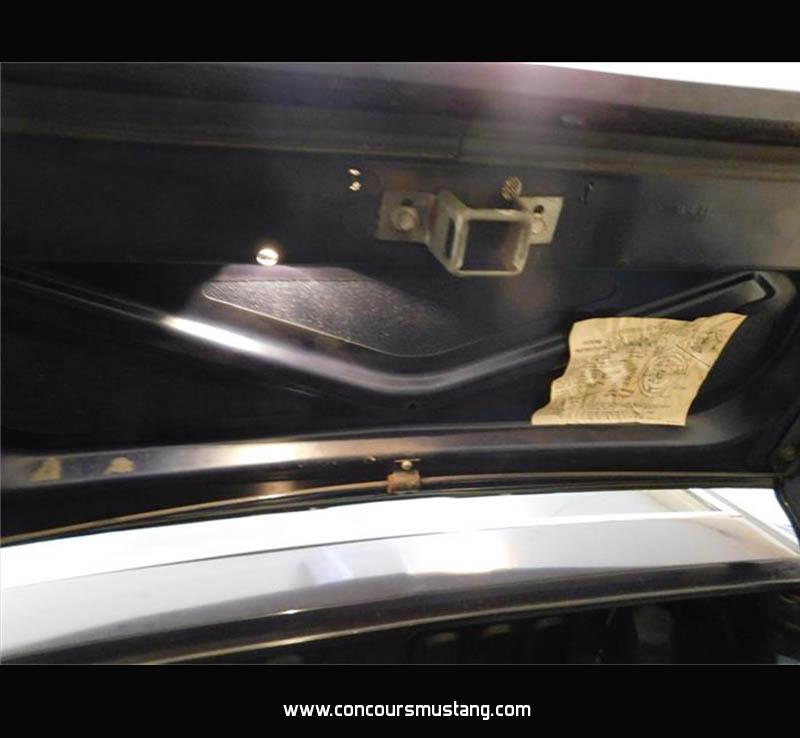

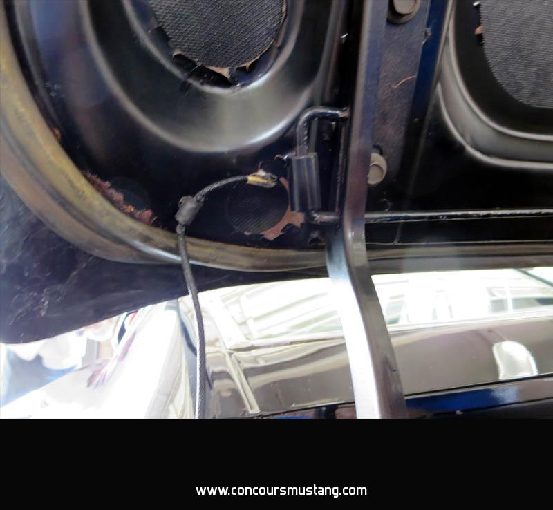

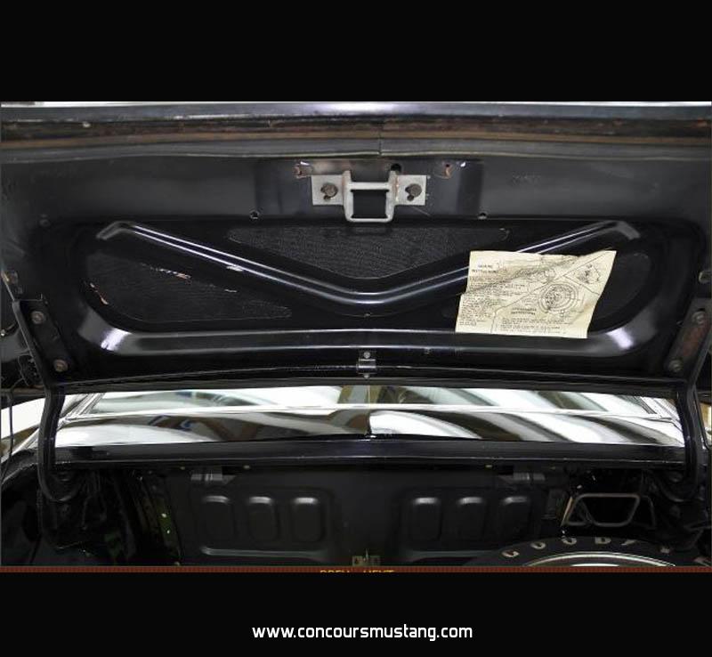

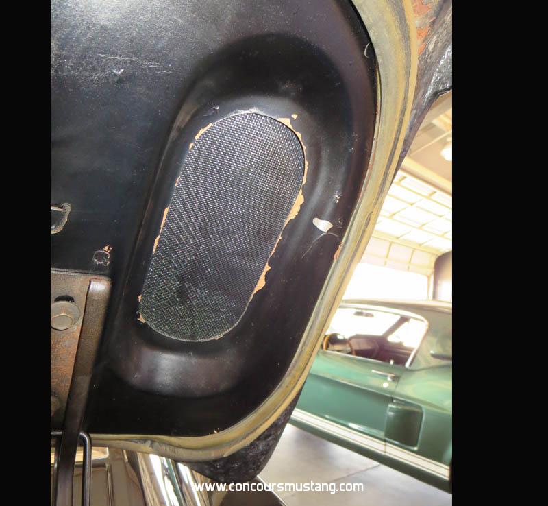

First thing to check would be the date code on the steel liner.  Trunk lid damage or issues would not automatically mean that surrounding sheet metal damage would also have to be evident
On the early steel lined trunk lids I've always found them to be painted body color on both sides
Here are a few originals though specific details are difficult to make out on dark colored cars and edge details due to the weather strip

Thanks for the details and pictures, Jeff.
I especially appreciate the paint answer.

I'd like to comment on the style of trunk lid catch in the two pictures above.   There are 2 sets of holes - one set fixed and one set slotted on both of these examples.    I have noted that my 67 Shelby has the same style catch and haven't observed one on other regular Mustangs I've seen.  I know there were several variations.
Is it possible that Shelbys got a different style than regular production?   Comments/observations?
Thanks,  Kurt.
They are found on unrestored Mustangs so you also find them from time to time IMHO on Shelby's  Don't know why the production difference in some other than possibly a second vendor. Nor do I know the purpose of the second pair of holes  though I know the subject has been asked and discussed over the years
