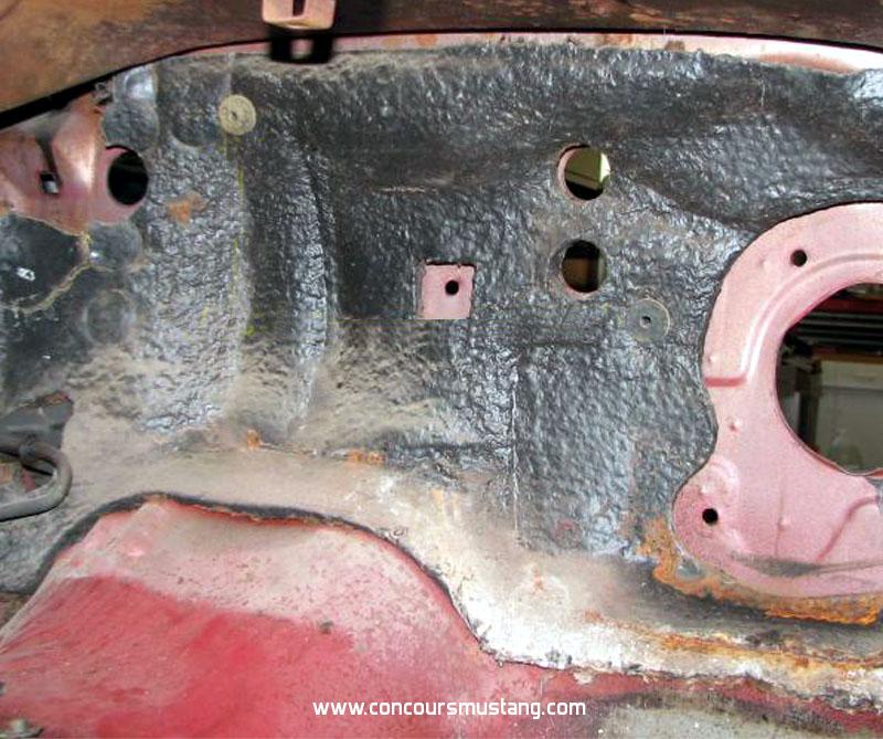

This does not surprise me speed, you are describing exactly how my firewall pad was when I disassembled the car for restoration. I am pretty much sure the piece where removed on the assembly line for whatever reason possibly to make it easier to install item going through the firewall like the wiring harness and other. I have attached two pictures of exactly how my pad was when I removed the dash and under dash components. I have also decided to put them back the way I found them with the pieces missing. Mine is also a 1970 and Dearborn built.
FYI stock wiring does not typically require tearing of the firewall pad. I understand how you came to your conclusion . I don't necessarily agree with it but it isn't my car ether.  Restoration is all about choices.  ;)

Thanks for the input Bob, I am not saying that is why its missing, just seems odd almost the exact same issue in both cars of the same year and possible build location.
The top over hanging piece of the large pad I am guessing is pretty flimsy at best so if it gets damaged or torn at all during assembly of the steering column or other components and if already mounted ans secured on the firewall it would be easiest to just tear off rather than replace the entire pad. I don't see any other reason why this damage would occur later to much stuff in the way, but may have, guess we will never know.

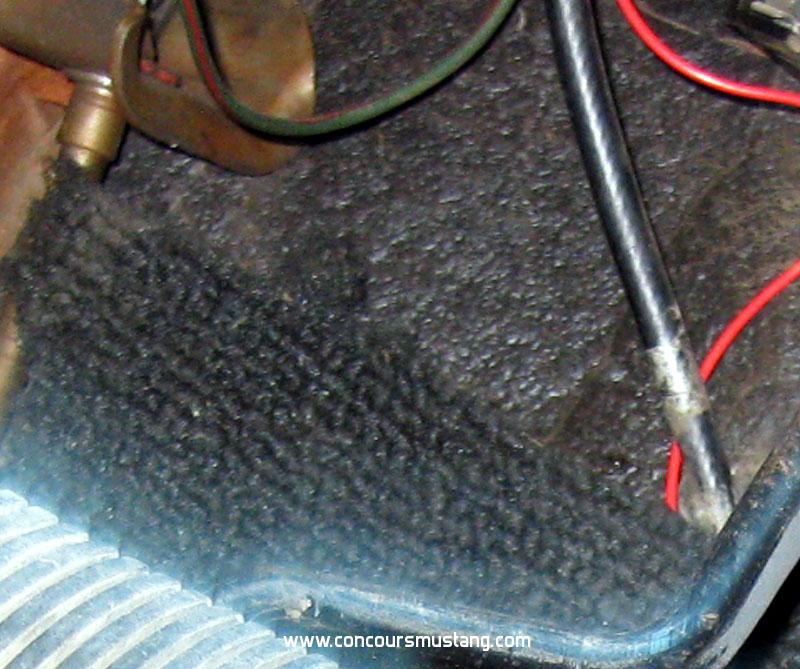

Here is one modified from an earlier thread. In this example it appears that they had a "San Jose" style then added texture over it at the supplier for some reason . Have seen a half dozen or more originals like this out of Dearborn
Couple of closes ups of another 70 Dearborn

Jeff, if I’m not mistaken, the top picture is my pad I posted several years ago.  My build date is 6/70.
Might be. It was used to illustrate the type of rubber retainers for the firewall pad to the firewall
