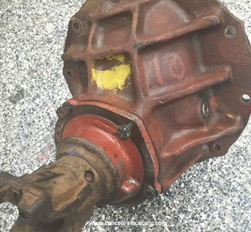

Royce, I have good pics of my '70 "N"-case 3.91 traction lok rear axle, but I'm not sure how similar it would be to yours.
Some pics below.  I can take or post more if there is interest.
*Pics are from a 1970 Cougar Eliminator, Built: Dearborn, Oct 6th, 1969.

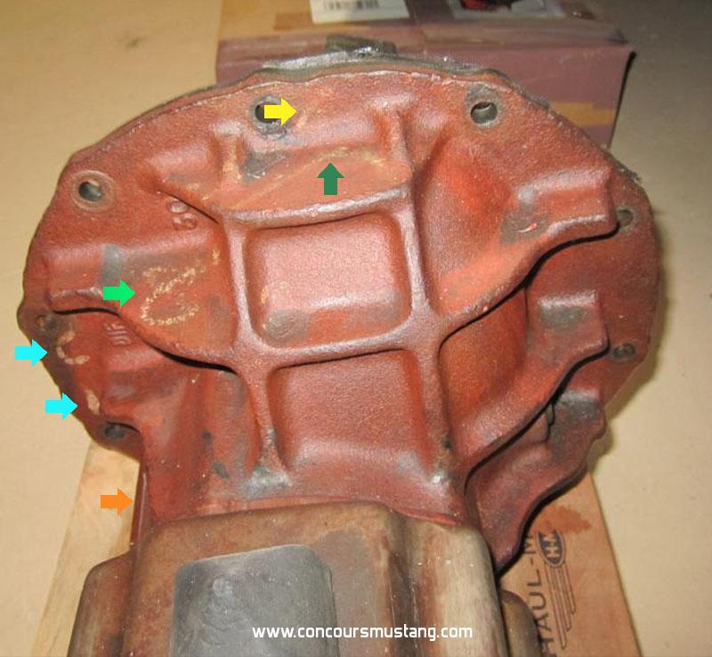

Trying to stay as close as possible to your build period here is an example of a case cast Dec 21 67
Pretty typical IMHO from others of the period
Yellow arrow - appears to be an assemblers or inspection number Haven't seen this location or size before
Dark Green arrow - may or may not be a mark
Light Green arrow- Another assemblers or inspection number Often seen here or in the "box" the dark green arrow highlights
Light Blue arrow -  Paint dribbles/runs often seen in this area from a assemblers or inspection number applied at or about where the Orange arrow indicates. As shown in the picture below. Colors range between light blue, pink, yellow and white so far
Orange arrow -  covered above
Take note that on the December example we don't see the large yellow blob we so often see on earlier and later 9" examples.
Second example likely from a number of weeks later. Assembler/inspector numbers rotate around slightly but not my much. In this example from the top center to the drivers side of the case
The typical blue (missing is the yellow) yoke marking is visible and this time the yellow at the top center has returned

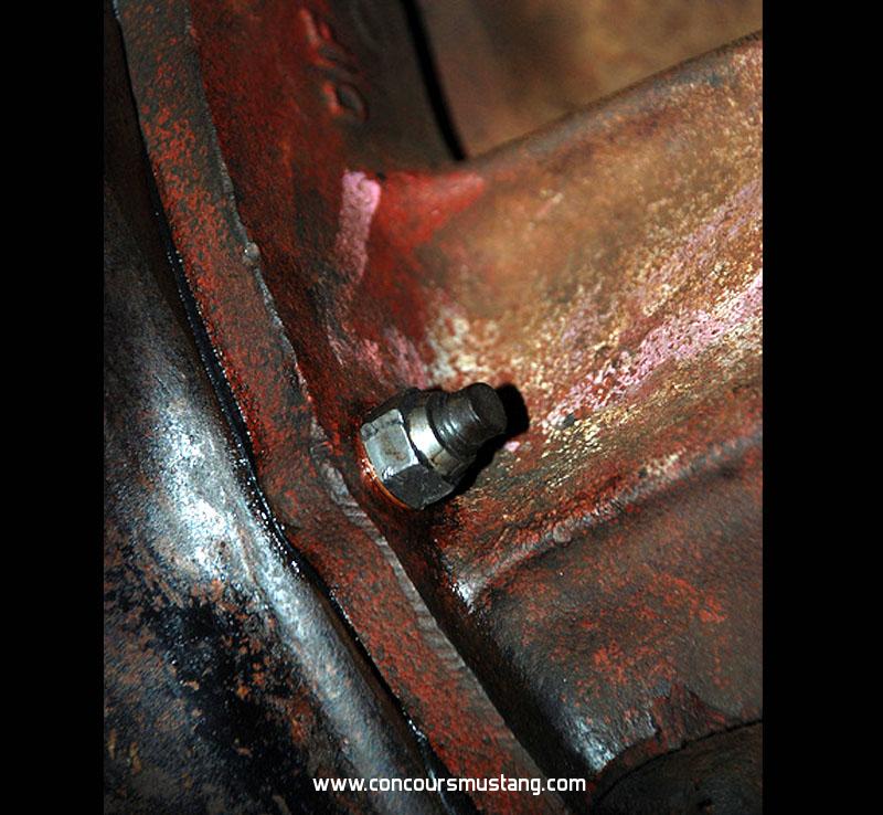

Mike,
Those are great. I wonder if you have any pics of the markings on the housing? It would I think have some kind of reference to the ratio or the tag number stenciled on or scrawled on the outside?
Royce, my housing is dirty as all get-out.  The only other marking I've found on it so far is the orange-red scribble on the driver's side of the pumpkin...

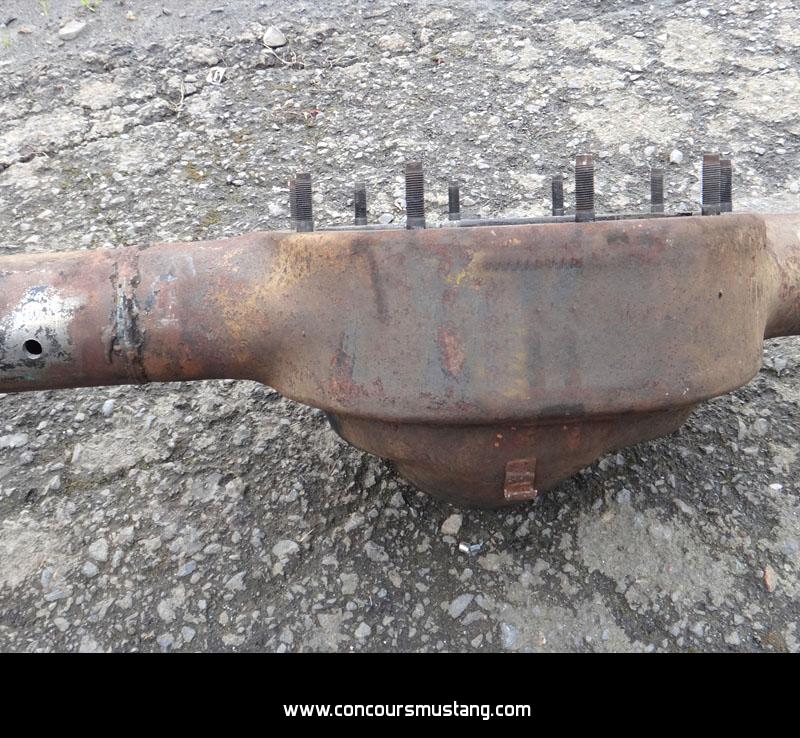

You know those archeological digs on TV where they excavate huge holes using only paint brushes? I felt like that today. I spent hours cleaning the center section and the axle housing using nothing but bristle brush and mineral spirits. It took ages.
I only found two markings, both on the housing. There was precious little paint left on any of it. I found what looks like a 6 or a 9 inside the housing. On the bottom of the housing I found what looks like YN.

I only found two markings, both on the housing. There was precious little paint left on any of it. I found what looks like a 6 or a 9 inside the housing. On the top of the housing I found what looks like YN.
Interesting - All the 68 9 inch examples I have show that housing marking on the exterior to be applied to the bottom as we see in many 69 and 70 examples
Are you sure that the marking is on the top not the bottom of the rearend housing?
My orientation may be off but thought the "bump" for the ring gear would be on the left if the picture was taken from over the rearend as installed and we could see the brake line retaining clip in the picture

Good catch, yes it is the bottom. I edited my comments to correct my mistake.
