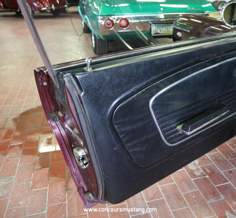

Re: 1966 burgundy convertible with standard black bucket interior
« Reply #3 on: October 13, 2018, 06:43:27 PM »
If your repainting your car make sure that you don't follow the weatherstrip location all the way around the door edge.  There are threads and examples that can help you with what the detail looked like depending on year and assembly plant ;)
Interior color was added first (before exterior color) to the door surface, dash and A pillars then masked off to protect them from the exterior color application

« Reply #5 on: October 14, 2018, 12:08:09 AM »
Great picture...also shows the correct installation of the weatherstrip.....Thanks
