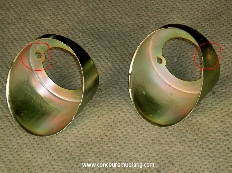

Good luck. I learned the hard way about working with acid. I'll let the pro's do it. As to over doing something, I don't call these overdone.
(PS - they were sold a long time ago.)

It's always difficult to determine finish quality of an item in a picture. There does appear to be what looks like rust on those parts, is that what I am seeing?

If you are fortunate enough to find a non-rusty part - use it. Your blow-up of my 64 1/2 parking lamp rings picture showed pitting, not rust.
