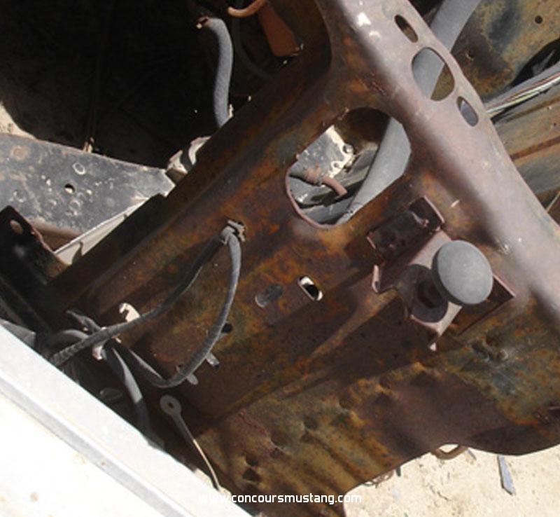

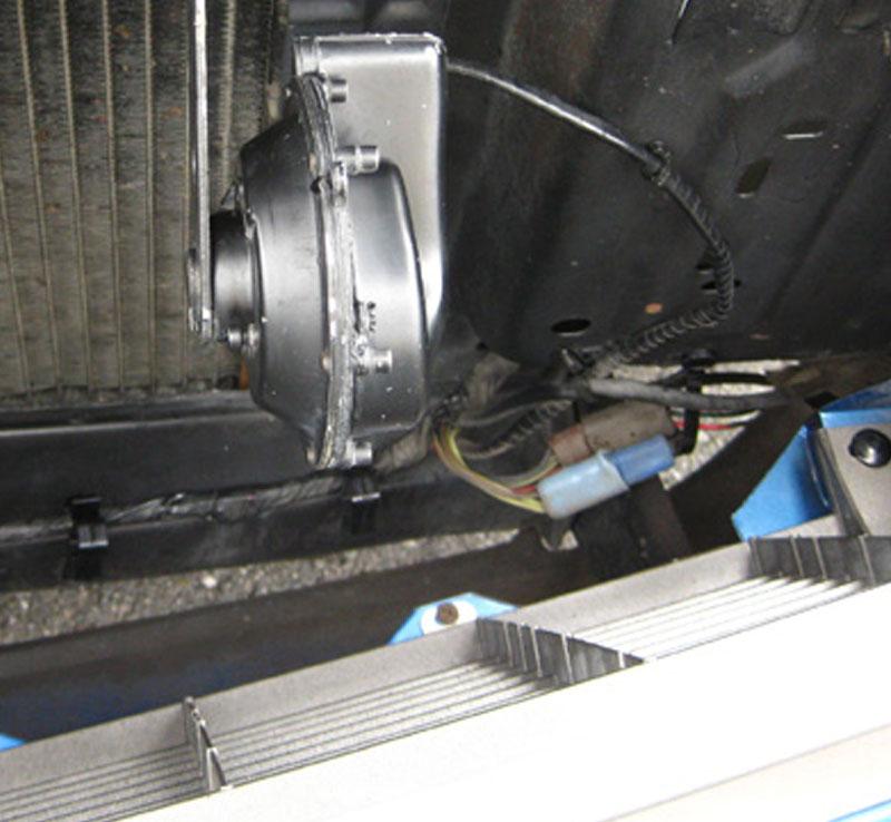

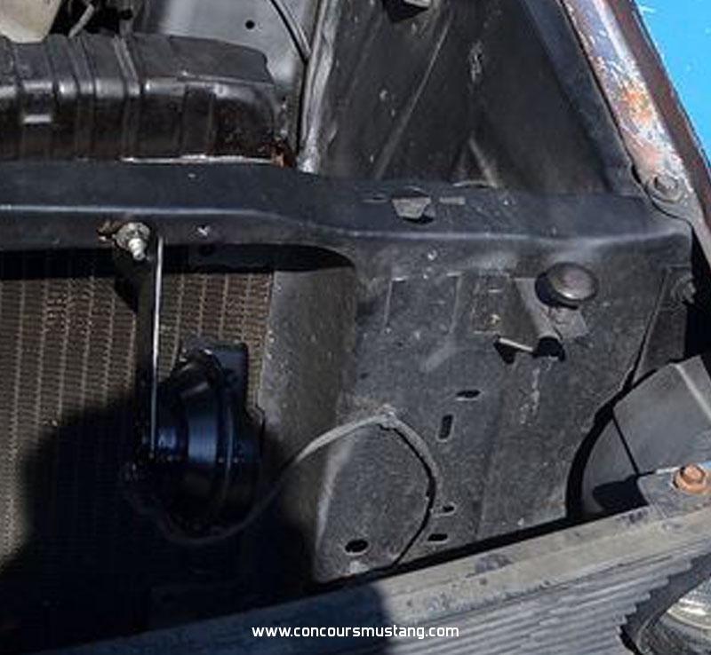

Since the focus here is more on how they (the cars) were originally built rather than judging or what you can get by with I offer the following examples
From early 70 production at Dearborn
0F1086xx
0F1151xx
0F1171xx
0F12166x
Looks like black is the answer

All the original cars I have here and have seen use the black clips for the horn wires.
