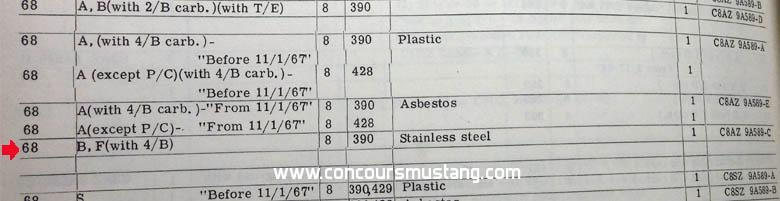

Thanks Jeff! I think that solidifies it pretty well, at least for my Feb. S-code. For others, it would be interesting to pinpoint when (or if) the C8AZ-G was used on S-codes.
Posting the '75 MPC info for reference.
