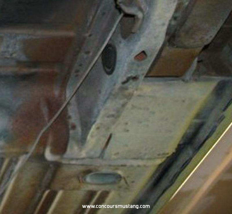

Jeff, this is a picture during the cleaning of the undercarriage. You will notice remains of seam sealer. What do make of it?
IMHO the car looks like it was never restored, seam sealer looks like it was there before body color and no undercoating anywhere. And yes it once had side pipes
Looks like the worker on your car made the turn and sealed the rear spring torque box panels to the floor.
Looks like someone sprayed your whole floor black at some point in the past. Can see red oxide floors, body color, sealant and black top coat. Can't see any spot where the body color and sealer come in contract in the pictures and of course with the black over everything at some point - no sign of the pinch weld spray
Dis save and enlarge the picture allot - thanks for a decent resolution picture :)

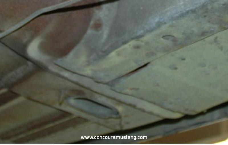

« Reply #6 on: February 01, 2019, 11:06:27 PM »
The red oxide you see is actually a brownish primer. We scanned the original floors  and we thought there was a mistake made when we opened the can of paint. It looked chocolate brown but shows up a pinkish hue in pictures with a flash or when in the sunlight. In this picture we can clearly see the difference between the floor paint and the weird strip of red oxide stripe that is on the passenger side behind the pinch weld. A similar stripe was found on the passenger side but in grey oxide.

« Reply #7 on: February 01, 2019, 11:19:33 PM »
you will notice that the car does not have its' original leaf springs. Somebody changed them for these DOZ.. Fortunately I was able to locate set of originals for the car. Not sure if they are date code correct yet.
