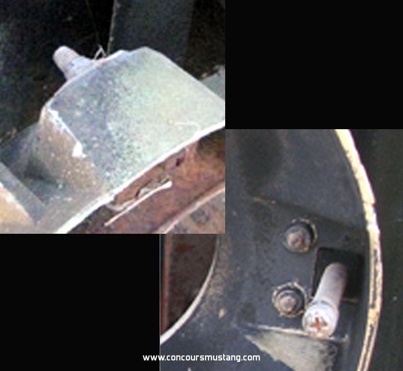

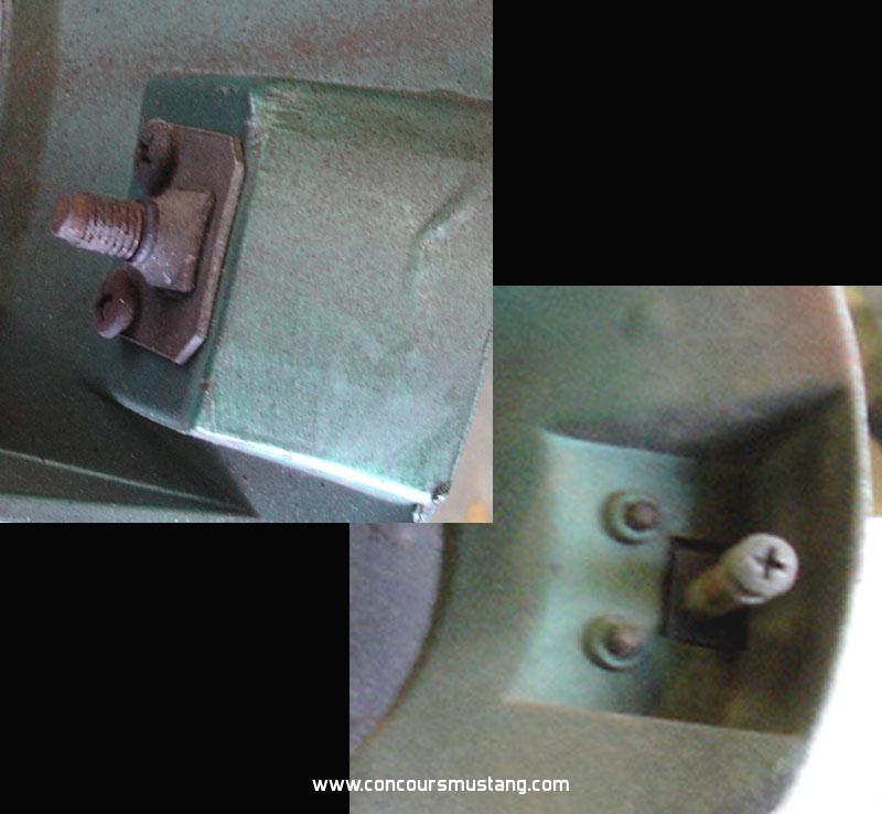

I normally find/see those retained by screws don't know that I've ever seen one where the brackets are riveted in place as your pictures show. Wonder if this was a repair from the past.
The brackets/blocks on your examples are on the inside of front of the headlight bucket where typically originals are on the back side. Looked through my library and looking at the examples I have (stopped after 100 of them) the brackets installed on the back side with Phillips head screws with flat ends (not pointed).  This does make the most sense considering the raised thread bosses on the front face surface at the cut out. The examples were from all three plants.
Some examples the ones I found
Did have a pair of 69 head light buckets handy in the back of the trunk that I snapped a couple of pictures of and I believe they are both service replacements based on a couple of clues. Those brackets/blocks were installed to the front side like your but used Phillips head screws with pointed ends. Would show pictures of those but it might lead others in the wrong direction  at this point in the discussion

I have to agree with Jeff. Having grown up on the east coast, NJ I have only observed adjusters mounted with Phillips head screws. I would assume most of the 69 cars I saw were Metuchen built as well as most of the parts at swap meets.
After looking at the original pictures, it would appear the rivets were a quick repair rather than reinserting the screws from the backside. The purpose of the raised boss would be the allow more threads and not as a spacer.

Another Metuchen with phillips head and flat end screws.  Brian
