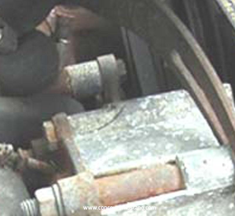

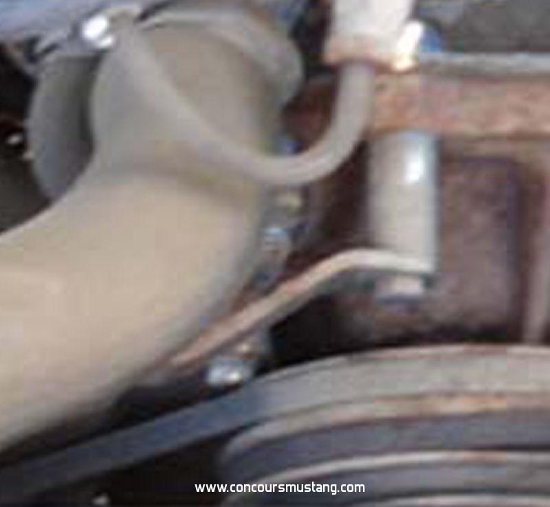

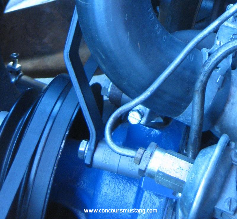

As promised found some pictures and though they are old, dirty and crusty (factory photos were too grainy to use) there appears to be some plating IMHO suggested by the pictures when you start comparing their finish to the items around them
First had allot that were just rusty. Along with the adjusting arm, bolt and sometimes water pump surface
They were also used in 66 for the same purpose. On these the finish appears to no longer be present if there originally
