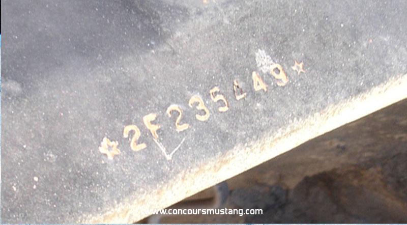

Mystery solved.  VIN present on both sides.  Barely there, lots of corrosion. Matches dash and title.  All good.
VIN stamp is on the outboard edge. Attached pic shows my 72 Q code stamping, on the visible portion with fender on.
The tape represents where the missing VIN actually is on the other car.

Re: VIN on shock towers
« Reply #7 on: February 24, 2020, 06:29:49 PM »

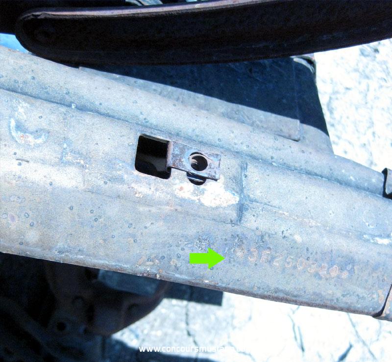

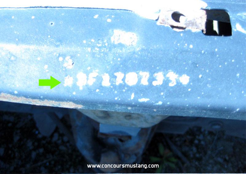

Good news The picture shows an unusual location as you have discovered
I also looked through my collection (not much with the fenders off on a 72)
And some 73 examples

« Reply #8 on: February 24, 2020, 06:40:55 PM »
Yes, it appears this car has the VIN in the standard location.  my Q code threw me off the scent.  I was thinking it was on that pad in between the two VIN places depicted.
Thanks for the assist!
I’m going to try to clean standard area on My Q code.  Perhaps it is double stamped.  Who knows?
